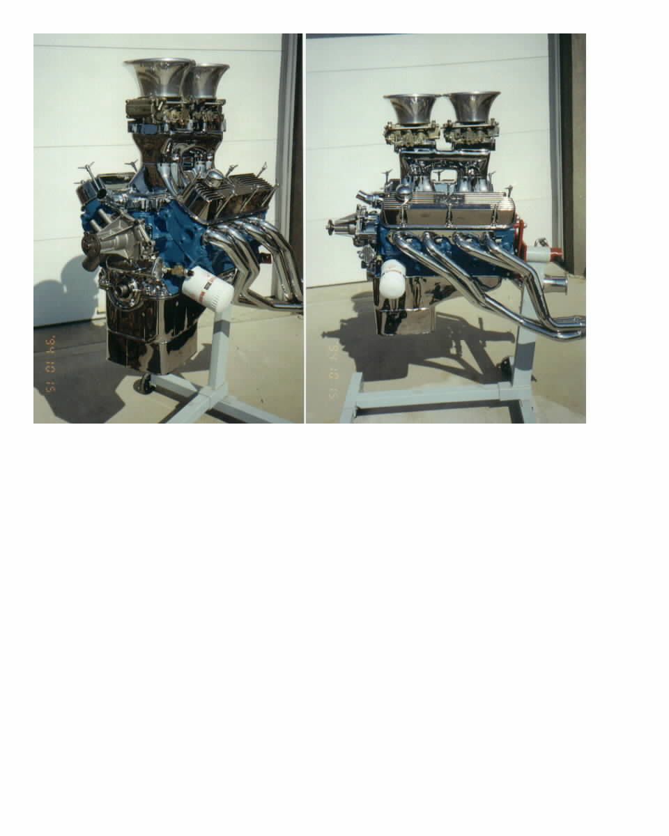

I have set up 2 TR systems for myself and one for a friend who has a street rod. Take this info or leave it but it works. I got this info by trial and error and talking with guys who actually run these cominations on the street and who actually don't LIE to you telling how good their combination runs on the street. I think only 2 out of 10 TR systems I see on street cars actually work decent. Here is the engine out of my mustang-see attachment.
1. Get rid of the 1850 4160 carbs and the sideways linkage. They were hardly ever run on the street in the day and were mostly race car only. Those 4160 double pumpers are way too much for any small block on the street even if they are vac. sec. You will end up with gas washing down your cylinder walls and will be rebuilding the engine by the end of the summer. Run two Holley 4150 carbs with 450 cfm inline. (600x2 =1200 cfm is way too much). I had two of the 600cfm 4150 carbs on my car when I got it. It ran o.k. but the 450's were way better and the 390's I finally ended up were the best. I think the very best carb is Holley 4150 390 cfm #6299 (with no choke) and vacuum secondary. That is what is in my pics. 6299 are discont. by Holley but you can find them on ebay just about every day of the week. Do not run the 390 carb Holley still on the books. It is an emision carb. I used the balance tube kit for the v secondaries and it made the carbs run incredible-great as a matter of fact. The balance tubes were not availble in early '70's but came out in '74 ish period. I'm very picky about being period correct but would run the tubes anyway.
