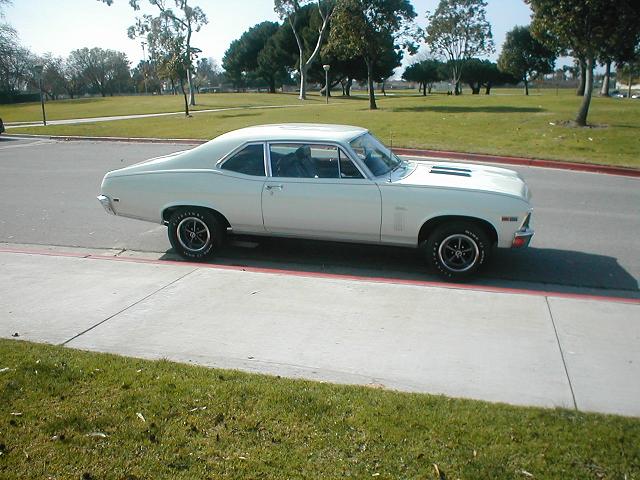

Here is a white 1969 with red bucket seat interior.
