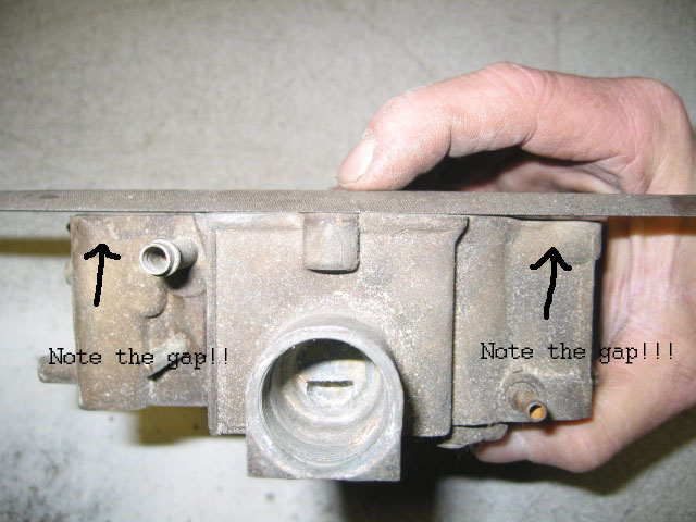

Over-tightened castings: Look at the front mounting bosses on the carb--are they deeply gouged and scarred? If so, someone has over-tightened the carb at some point, and you can just about bet that the carb is warped.
Sometimes they can still be used if they're only slightly warped, but if they're too badly warped, they'll never seal up and aren't safe to use.
Here's another way to spot a warped carb; Look at it dead-on from the front and see if you notice a "crown" in the middle of the casting between the main body and top casting.
This one looks good.
