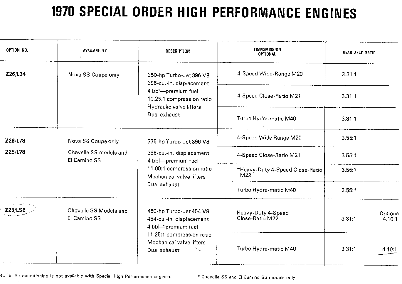

How would i find out what the rear axel ratio that would have come from the factory on my new toy(70 chevelle SS) the window sticker just says Option G80 Positraction Axle.
Is there a good reference site for this ?
