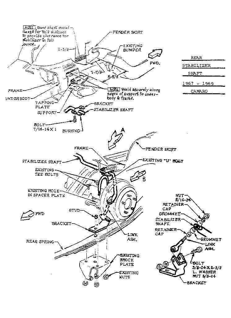

Default '67 Camaro Rear Sway Bars?
The '67 Z I have been attempting to buy (looks like the deal has gone cold AGAIN thanks to an IRS paranoid owner) has a rear sway bar on it. It does not appear to be the same as the GM units that I have seen in a few books. Was anyone else making rear sway bar units for these cars? The bar itself bends around the pumpkin not like the straighter GM bars. Thanks in advance,
Mark
Attachments - The Supercar Registry 68160-67-69 rear swaybar parts.jpg 68158-67-69 rear swaybar.jpg
