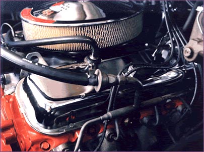

I'm hoping you guys can save me some research time regarding what's available as far as Left Side A.I.R. tubes are concerned. One of the attachments is from the Benchmark LS6 website and shows a photo of the left side A.I.R. tube that makes the hose connection, essentially in the middle of the cylinder head. The other attachment is the one I have that looks peculiarly similar to the one Iíve seen on COPOís and Big Block Camaros.
Assuming that the Benchmark LS6 car has the correct piece:
Are there any of these to be had?
Is there a Re-Pop of this exact piece?
Or is the Re-Pop piece the one shown in the second attachment?
And, if the second attachment is a Re-Pop, is this acceptable?
Continually trying to be Anal Restorative as opposed to retentive. ...SWB...
