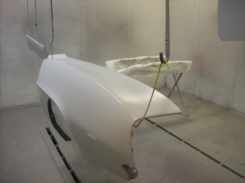

With all of the floors and firewall done as close to factory as possible, the next focus will be on the final body prep with assembly of the front clip. Before doing so, I should ask:
4.) Are there any factory specific applications of primer/paint/color on the inner front fenders, front valances or the fender extensions that I should be aware of prior to assembly and final paint?
