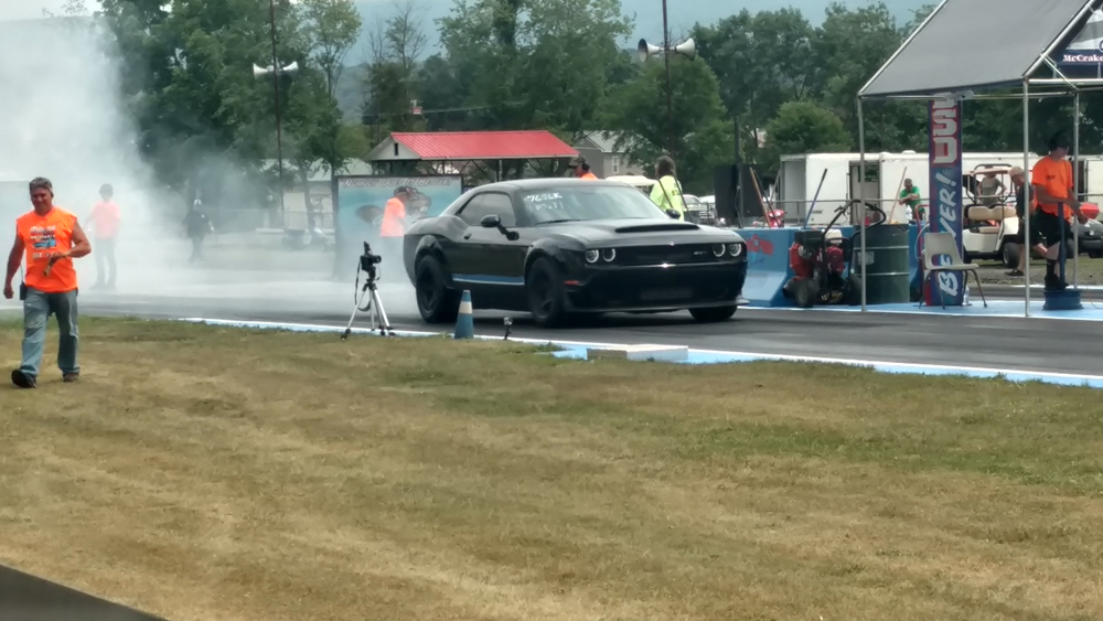

Pair of Dodge Demons Rear Ends Exploding on Drag Strip

The video, which The Drive can report has now been seen by Dodge's highest executives, shows the rear axle detonate on both the modified Demon and one of the stock models in brutal slow motion. The first clip in the sequence features the hotted-up Granite car. Just as it rears back and lifts the front wheels, a shudder reverberates through the chassis. The front comes back down onto the track, now joined by the inner assembly of the rear differential, leaving a trail of gears, oil, and metal shards in its wake.
In the second clip, a stock Go Mango Demon struggles briefly with a balky transbrake—you can see it rock back and forth prior to the doomed launch—before suffering a similar fate as it leaves the line This time, the failure appears concentrated near the front of the differential, possibly with the pinion gear. But the result is the same: A glittering, greasy mess, and a broken car.
