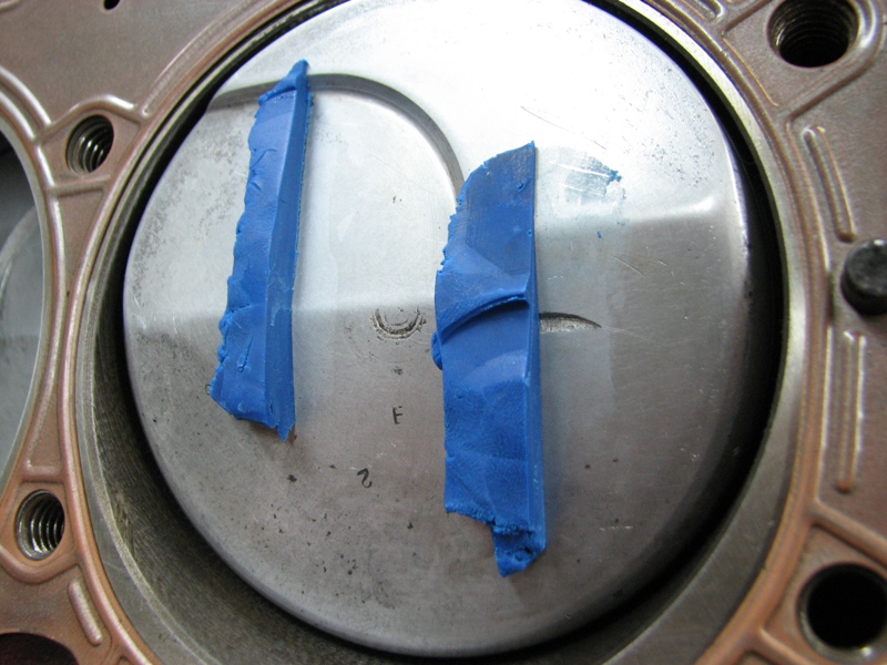

Spin the short block over, switch back to the handles and pop off the head. slice the clay in half and measure it.
Name:  Valve clearance clay.sm.jpg
