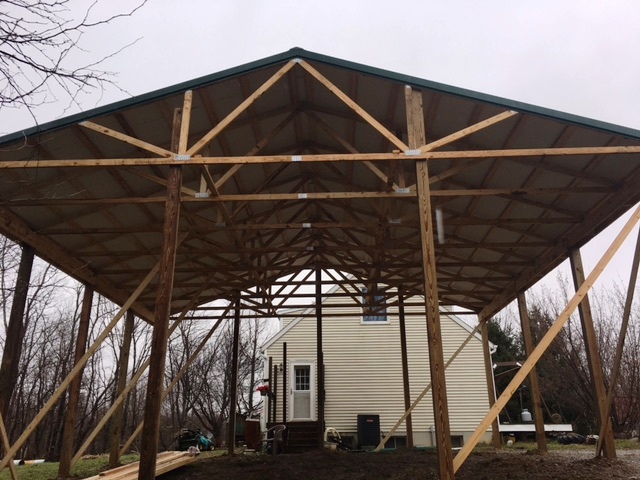

On a budget, so a post frame, no frills building. Goal was just to get roof on and do more as weather allows. 32'X32'X12'. 12' so eventually a couple of 4 post storage lifts can be added. A 10' X 32' loft in the rear is planned. I designed this for 3 cars with either 3 more in the rear or 2 long ways. So, at least a 5 car without shoe horning and the ability to go up for more storage. The door closest to the house is wider to accommodate opening car doors easily as our everyday vehicle will reside there. The yard falls off steep on the LH and rear side, so this dictated the size.
