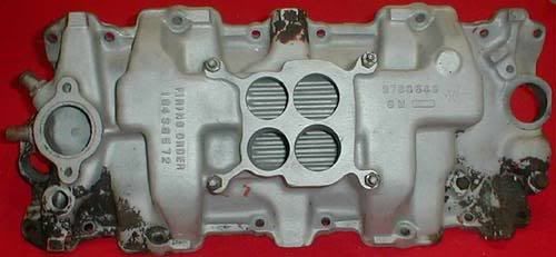

This is from a google search.
"This picture is of the aluminum #3780540 intake used on the 1959 305hp (with manual trans) and the 320hp 348."
All info I find states 58-59 348. You are right Howie, with that date one would believe it was for a 1960. I think it was just a late casting for over the counter use. https://www.yenko.net/ubbthreads/imag...lins/dunno.gif
http://i115.photobucket.com/albums/n...8409intake.jpg

Kim,
There's a lot of controversy regarding that manifold due to some inaccurate published data. I can assure you, that intake was used on the '61 340hp 348 and the first '61 409s. Most people believe the '59 story, but I'm absolutely certain my info is accurate.
Also, the 586 heads are '61 409. Quite rare and valuable.
Hope this helps.
