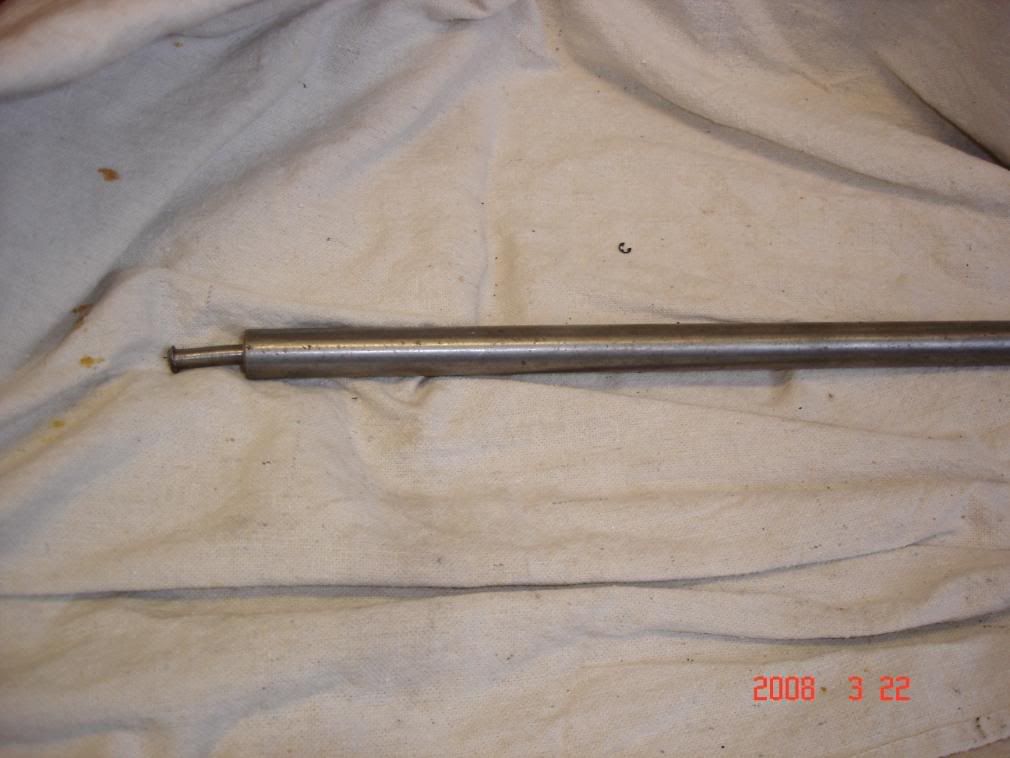

Eric..........As I remember.....as usual.....The Repro dash pins ( I know that you will find this hard to believe.....LOL) are not made correctly and are a bear to get in.........I made a Tool that pushed on the Tip and the Face at the same time.....even with that I got them in ......but....Not exactly correct.......Here is a Picture of the Tool that I used.....I have since destroyed it by using it to beat something apart, But I think you will get the Idea..........Repro Parts "SUCK"

I just got a phone call from another forum member with their solution to the issue, and it's strikingly similar to yours...a shouldered home-made tool. https://www.yenko.net/ubbthreads/imag...iggthumpup.gif
