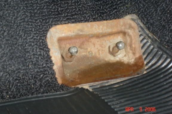

John Brown 02-01-2008 03:11 AM
Re: 70 Z/28 gas pedal
Actually I think there is a plate with two ball mounts attached to it that bolts to the floor. The pedal pops onto the balls that stick up as I recall.

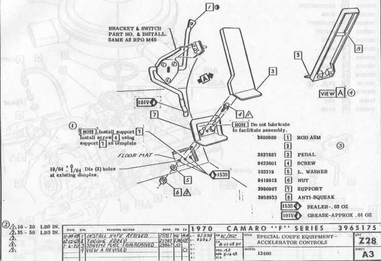

CamarosRus 02-01-2008 04:28 AM
The below pictures show the special pedal, bellcrank/rod and mounting cup that make up ALL 70/71 Z-28 gas pedals.
In so far as I know, the actual firewall mount and pull cable are the same, as the standard set-up
http://img.photobucket.com/albums/v4...0-30-05104.jpg
http://img.photobucket.com/albums/v4.../gas_pedal.jpg
http://img.photobucket.com/albums/v4...edal_mount.jpg
camarojoe 02-01-2008 05:18 AM
Just out of curiousity, WHY was the gas pedal different on a 70 Z? Seems weird that the Chevelles, Novas, and any other Camaro besides the Z/28 used the "standard" type pedal and the 70 Z used this oddball setup. Anyone know what the rationalle was for its use?
RamAirDave 02-01-2008 05:35 AM
I was just going to ask the same thing, Joe.
gadrix 02-01-2008 05:35 AM
My guess would be: The Z28 was road raced, the others...not so much. https://www.yenko.net/ubbthreads/imag...lins/dunno.gif
Johnny Horsepower 02-01-2008 06:50 AM
to further that comment, which I believe to be a good theory, maybe they thought it would make for easier/safer heel toe shifting?!? ie your heel or foot edge would not get caught under the pedal during a downshift while road racing.
that is my hypothesis
John
L30M20 02-01-2008 07:55 AM
And you are correct Johnny!!!!!!!!!
RamAirDave 02-01-2008 09:16 AM
Interesting. My 70Z is a TH400, so I can't say from experience. I do know that heel/toe is pretty much impossible on the pedal setup on my GTO https://www.yenko.net/ubbthreads/imag...thumbsdown.gif
