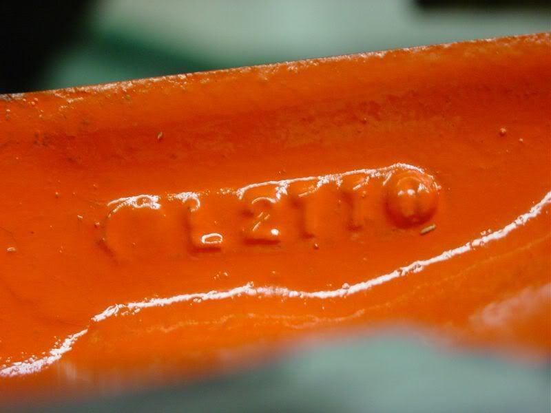

70 Forest Green Zee 01-29-2008 03:52 AM
Re: 3970010 blocks with December "M" in casting date
As far as I know "L" has always been the date code used for December....example:
http://i97.photobucket.com/albums/l2...n_DSC00041.jpg
