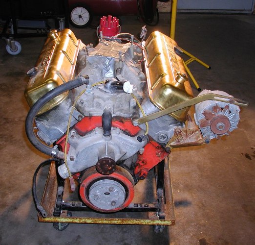

Here are pics of my 69 Camaro SS L-89 engine with one 842 head 3/69 and the other 5/69. No plugs in either end.
http://i3.photobucket.com/albums/y86...6/DSCN3622.jpg http://i3.photobucket.com/albums/y86...6/DSCN3645.jpg http://i3.photobucket.com/albums/y86...6/DSCN3647.jpg Paul |

427king & Hotrodpaul, Thank you for clearing this up. I certainly learned something! Is the exhaust valve face diameter 1.84"? |
