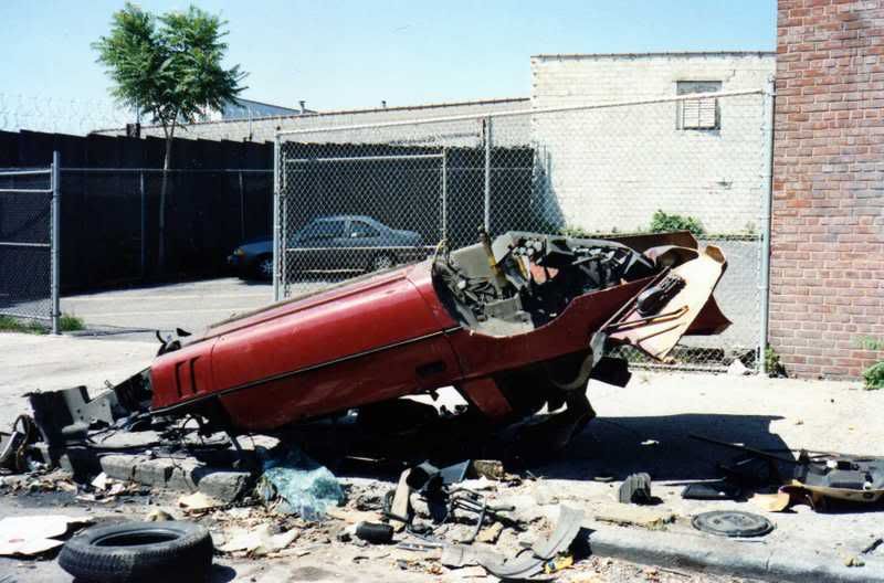

Dog427435 11-11-2007 02:06 AM
Re: Windshield Removal and Tool
I worked in Hunts Point (S.Bronx) for over 10 years. Hunts Point probably has more used auto glass dealers in
1 sq. mile then in the whole state of NJ.
I would watch in amazement as people popped front and rear windshields out of cars (legally or not) by sitting
on the roof and working a piece of piano wire under the glass. The process would take less then a minute
and I never saw one broken!
They could strip a car at the curb to nothing in hours!
This new Vette was parked by my building when I left one night and looked like this the next morning.
http://i158.photobucket.com/albums/t...evy/car019.jpg
