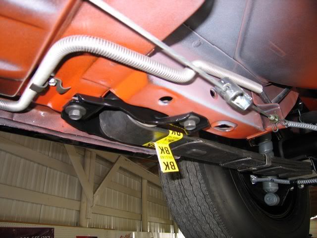

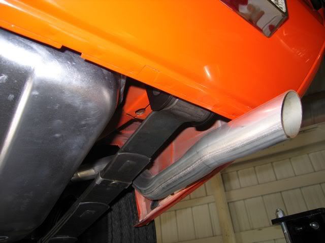

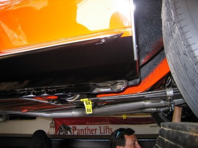

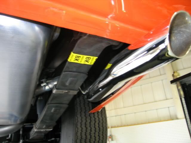

Arone/Pascoe/SCW L-89 Camaro below
http://img.photobucket.com/albums/v4...n_IMG_1107.jpg
http://img.photobucket.com/albums/v4...n_IMG_1108.jpg
http://img.photobucket.com/albums/v4...n_IMG_1109.jpg
http://img.photobucket.com/albums/v4...n_IMG_1117.jpg

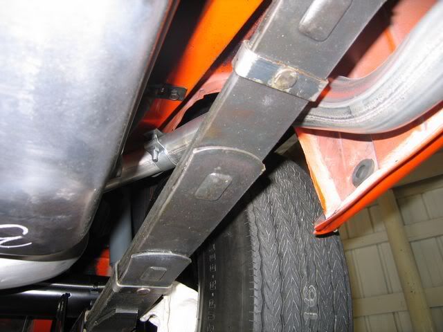

Larry Christiansen resto below
http://img.photobucket.com/albums/v4...n_IMG_0841.jpg
