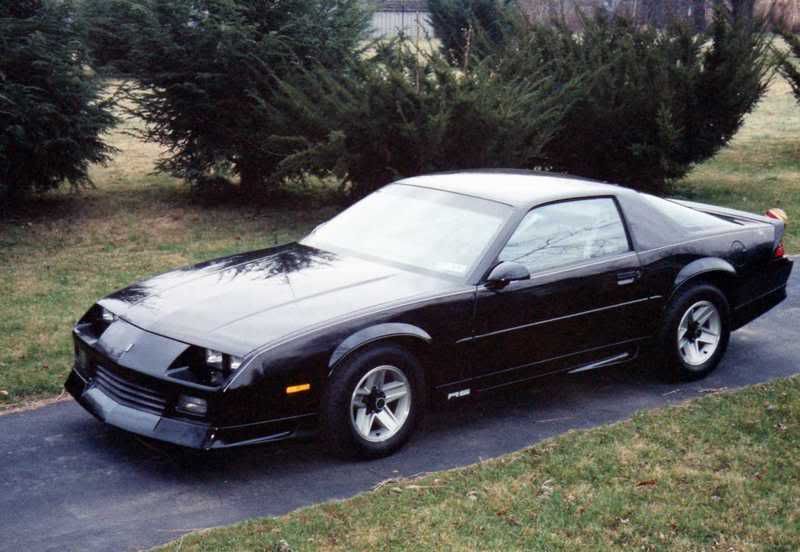

My '91 Camaro has been sitting a few years in dry heated storage. I rebuilt the motor and have taken it out
the last couple days. The interior is in mint condition and the headliner was in perfect shape. After a few days of driving the car, the headliner has started to sag from about half a foot past the sun visor to just past the front seat on both sides. Does anyone know of a fix other then tearing it out and replacing the whole thing? Thanks Glenn - - http://i158.photobucket.com/albums/t...evy/car041.jpg - |
