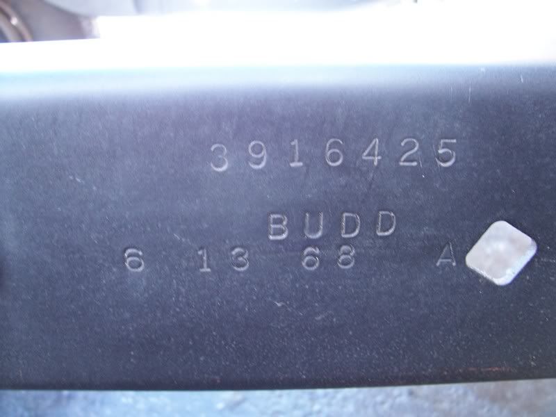

Not to hijack this post, but one of the posts above insinuates that Budd frames were heavy duty - From all of my research, I was under the impression that the three frame suppliers: A.O. Smith, Flint Frames and Budd, supplied the same type of frame. They were all the same. Can anybody comment on this? If Budd did make a heavier duty frame, what was different about it?
Thanks
3macs1 05-31-2007 06:21 PM
Re: Spiral Shocks
Hi Rob:
I will let the experts comment but I have never seen any major differences.It seemed the manufacturer of your frame was determined based on the location of where your car was built. I have taken Budd frames out of 6 cylinder cars and we have two in our 427 cars.Have to love the SO cal ones.
http://i65.photobucket.com/albums/h2...s/106_1407.jpg
68Biscayne427 05-31-2007 06:24 PM
Re: Spiral Shocks
That's how I understood it too. Jon Krogh also told me the same thing... And he has taken apart scores of cars. You never know though... https://www.yenko.net/ubbthreads/imag...lins/smile.gif
