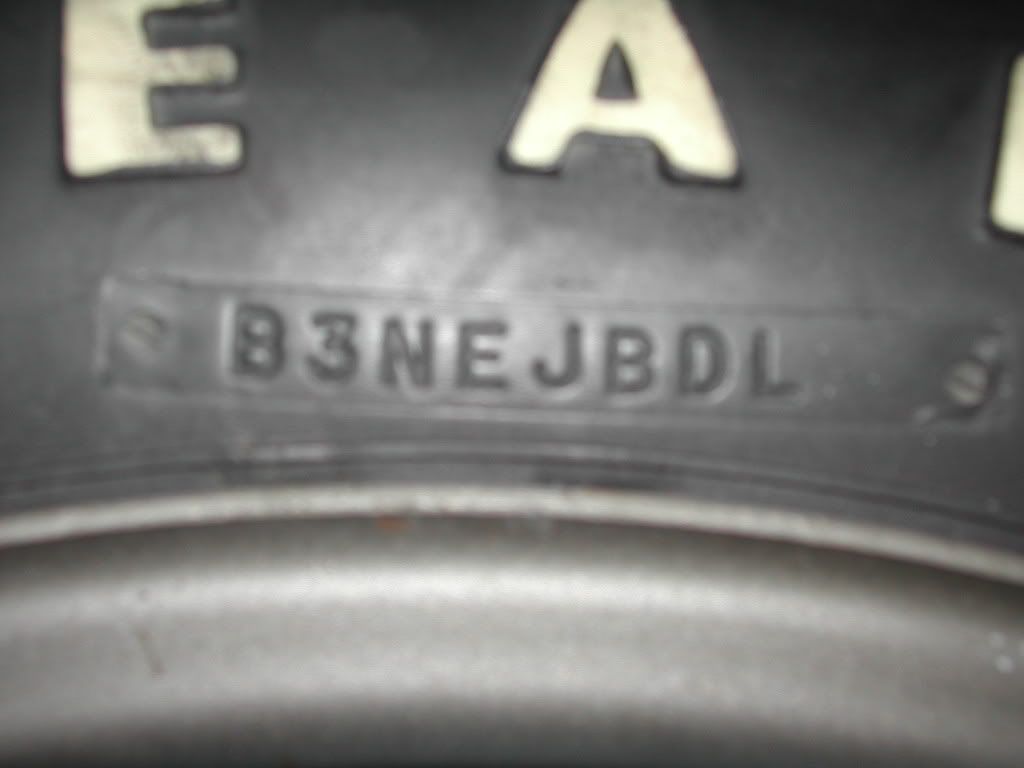

Mr70 08-22-2006 06:10 PM
Re: Goodyear Tire Date Code ??
I can't figure out your other code.
It looks of authentic origin,but possibly missing a digit or letter?

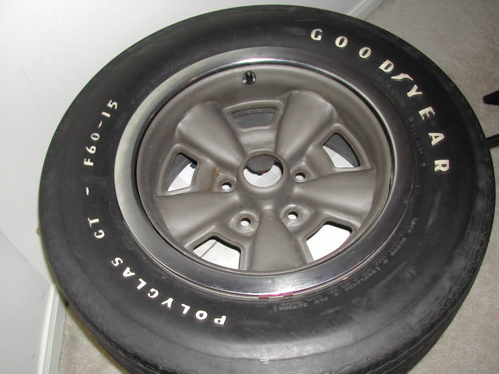

Hotrodpaul 08-23-2006 05:25 AM
Pics
http://i3.photobucket.com/albums/y86...6/DSCN4817.jpg
http://i3.photobucket.com/albums/y86...6/DSCN4818.jpg
This is the original, never used late 70 wheel and tire.
Paul
