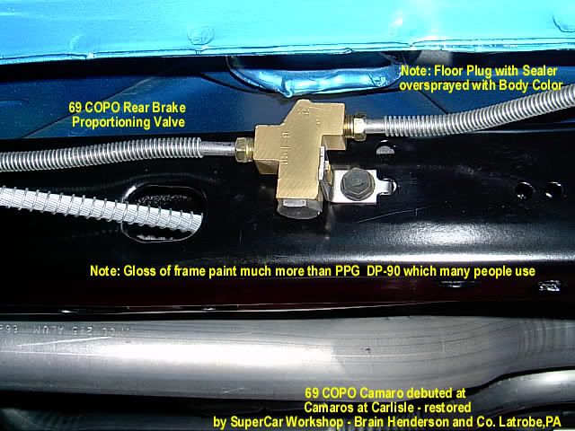

Jeff, From all the misc restos and articles I have seen or read over many years I am thinking a black "between dull & semi" is not shiny enough to replicate original. I used Delstar Acrylic Enamel with various amounts of flattner. I am not happy with durability and will change to ?? next time. I also used DP-90 as primer and am thinking maybe an etch primer or ? would have been a better foundation for the black. Difficult area to get correct, if you intend to drive a car, even occassionally.

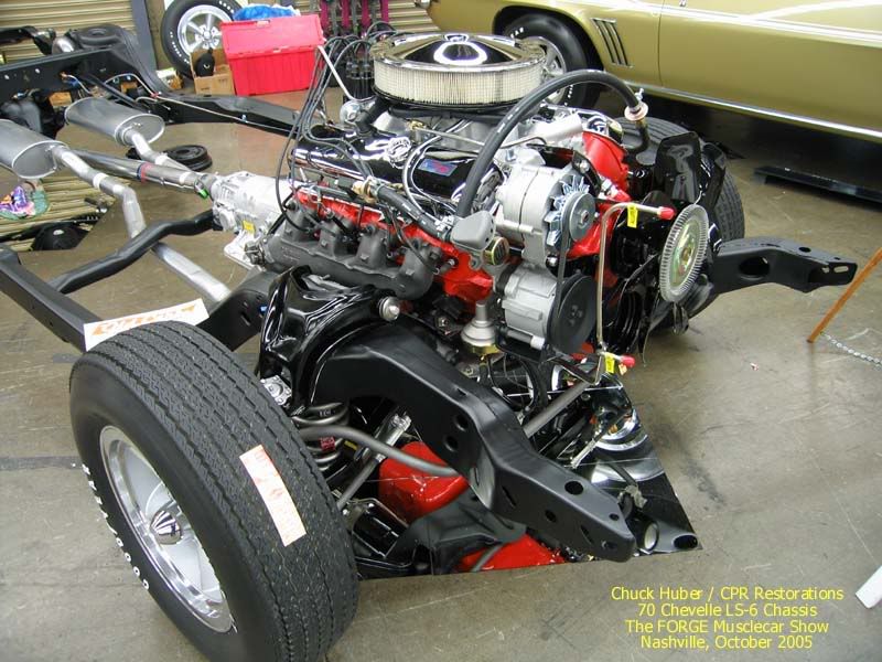

I also offer pics taken of a SuperCar Workshop COPO and a Chuck Huber frame, which appears "duller" than Original ?
http://img.photobucket.com/albums/v4...Crossshaft.jpg
http://img.photobucket.com/albums/v4...pics/Huber.jpg
http://img.photobucket.com/albums/v4...framePaint.jpg

YENKO DEUCE REGISTRY 03-07-2006 02:47 AM
Re: Glasurit BASF Paint System
The amount of gloss in the factory blacks depending on a lot of things, plant, person, temp & humidity being a few. I don't think there is a perfect sheen to strive for.

YENKO DEUCE REGISTRY 03-07-2006 06:04 AM
I think most judges recognize the point that I was making, and judge appropriately. The best advice is to simply duplicate what you find on the particular car that is being restored. Pull a boot off the firewall for eg. and there's your guide!
