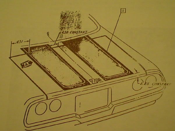

If you think it was spoiler delete, Here is your print, The assembly line workers had a way of making those holes larger to allow for spoiler adjustment to get them to fit also. Anyway, here is what It would have looked like. I have seen a couple of Bare bones Z's with no spoilers including a wild '74 with the big decals and no spoiler - now that was a trip..
Phil https://www.yenko.net/ubbthreads/imag...lins/beers.gif
http://i6.photobucket.com/albums/y22...PO/Cnv1065.jpg

Phil thanks for posting. Is that out of the 72 book? Maybe it was a spoiler car? What do you think about the marking on the spoiler in the photo?

There should be 2 springs. Doesn't matter if you have a spoiler or not. The spoiler option uses heavier springs. One is larger then the other. If you can find a late model Z/28 such as a 1979-81 the trunk springs are the same and will work.
Believe me you can tell if you have the correct springs for the spoiler. I have the spoiler off my 70 Z/28 at the moment and when I open the trunk it flys open in a hurry.
Although you see a lot of these cars with the metal Z/28 emblem I am 99.5% sure the 1972 used the decal.
If you can find an assembly manual it will show you the correct placement for the emblem with no spoiler.
Phil posted it while I was typing.
Rick H.
