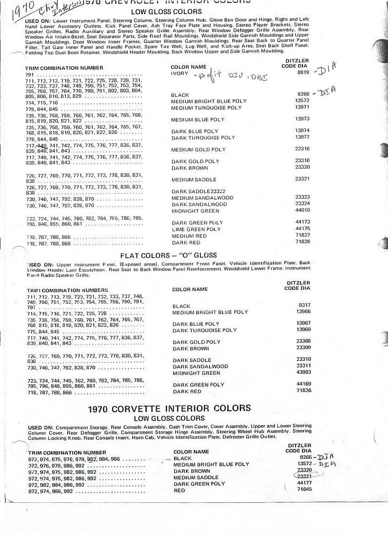

CamarosRus 10-14-2005 11:54 AM
Re: 69 Camaro dash top paint
Here is 1970 PPG Interior Colors, which I would THIMK is same as 69, at least the Blacks....Hope this is of help???
Chuck S
http://img.photobucket.com/albums/v4...int1970Int.jpg
