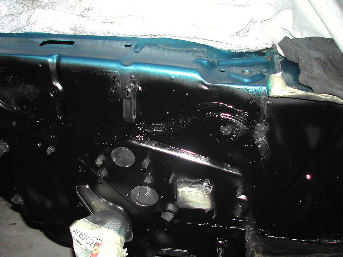

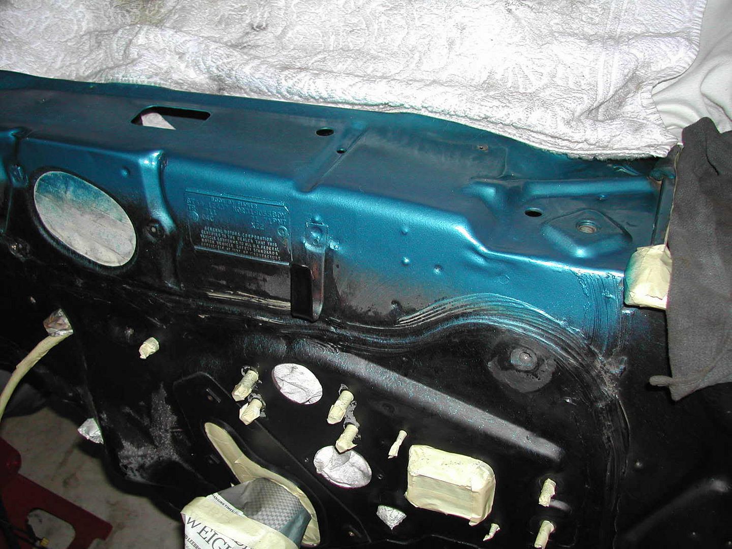

Hotrodpaul 07-30-2005 04:37 AM
Re: Firewall Painting Questions
Here is the firewall painted with overspray about 1-2" down the firewall. I used PPG Lacquer mixed to match the original color since most of the car has the original paint.
http://i3.photobucket.com/albums/y86...6/DSCN0048.jpg
Then I hand sprayed Omni Urethane black with a flattening agent to acheive about 50% gloss.
http://i3.photobucket.com/albums/y86...6/DSCN0051.jpg
Looks pretty good without using a template. The paint is still drying at this point. I almost felt like a Norwood plant employee doing it!

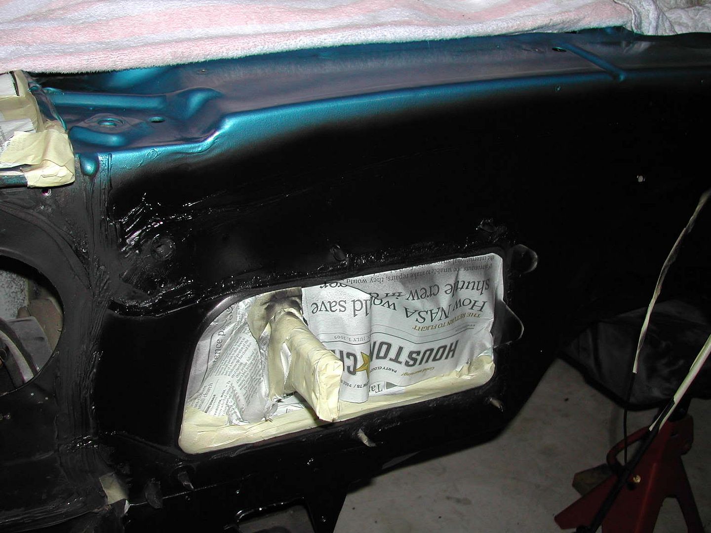

Hotrodpaul 07-30-2005 04:42 AM
The other side:
http://i3.photobucket.com/albums/y86...6/DSCN0050.jpg
