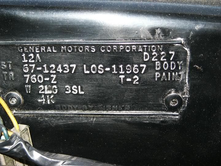

Take a look at the 4k on this trim tag http://cgi.ebay.com/ebaymotors/ws/eBayIS...item=4561917530

I think both the 2LG and 4k codes look very suspicious, compared to the 3SL code, which IMO is authentic/original to the tag.

Not to mention the pop rivets holding the tag on. https://www.yenko.net/ubbthreads/imag...s/rolleyes.gif

The car is too early for a 396 isn't it ???
Actually December 1966 was when the 396 became available. Seeing that it is a 1st week December car it just might be. I said might. The 4K looks strange to me as well.

This car is coded as an L78 (4K), and from my research this option was introduced sometime in March of 67. There is no way that this car is a true 12A built L78. The L35 was introduced prior to the L78 and 12A is too early for that.

Taking another look at the trim tag, it looks like somebody put a L right over the 4, on the 2LG code.
Looks like the L is covering the M..automatic car... https://www.yenko.net/ubbthreads/imag...s/rolleyes.gif

I would walk away just because of the home depot pop rivits https://www.yenko.net/ubbthreads/imag...mlins/haha.gif https://www.yenko.net/ubbthreads/imag...mlins/haha.gif
