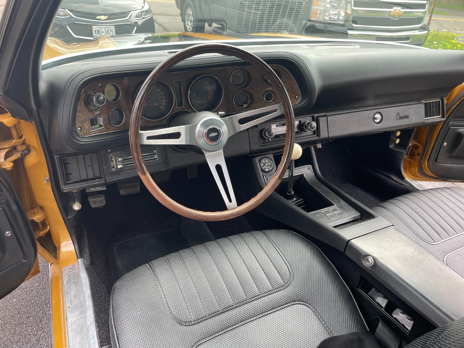

Caution Fan is the first clue.
Late BrakeU2 10-08-2022 02:13 PM
Window sticker.
olredalert 10-08-2022 02:49 PM
----What happened to the steering wheel?.....Bill S
Ricks72Z28 10-09-2022 12:46 PM
Missing floor gas pedal….
olredalert 10-09-2022 03:14 PM
----Thanks! I always forget to look.....Bill S
oldstv 10-09-2022 10:31 PM
Is that always an absolute?
I did reach out to the guy for a phone call but he didn't respond.
BCreekDave 10-10-2022 12:18 AM
There are cases where it was incorrectly replaced during a resto. Sometimes when the floor pan is replaced and the replacements do not have the holes punched through. From the few photos it would need closer examination. The dash cluster bezel is wrong. The clue is the windshield washer switch is from a 72 or 3 or 4. Probably other things.
Looks like the auction was ended early.
