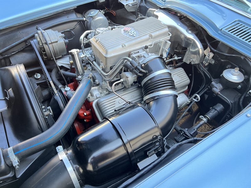

Nice looking car - $99k doesn't seem like a terrible deal in this market. Blue interior is a beautiful thing....

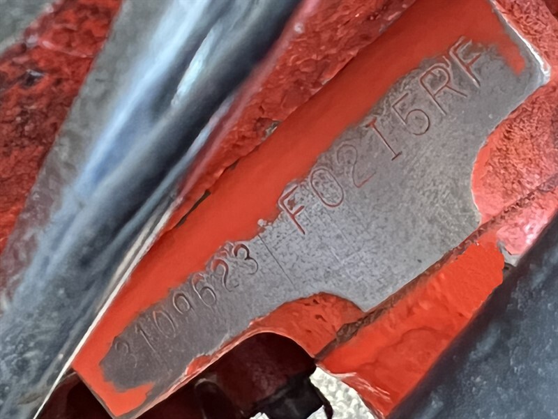

30867S109623
olredalert 07-30-2022 05:13 PM
----Appears very nice! The seat covers are reproduction as the pleats aren't deep enough, but were installed well. I'm fairly sure that there should be an idler pulley on the left side of the engine and you can see the unused space on the pulley.....Bill S
SupremeDeluxe 07-31-2022 02:57 AM
Not sure about the stamp. Cheap plastic older repro S-Tube. PCV tube is all wrong for a 63, not sure what year or model that came from. Repro crappy seat covers. Radiator seems incorrect, I don’t see the part number or date stamping. Missing a few pieces of shielding. Serial 96xx should have 4 hood wedges not 2.
olredalert 07-31-2022 03:48 PM
----Missed that stuff, SD! I think I was focusing on the lack of the idler pulley. Rummaging around yesterday I found an NOS one. I should try to make a sale,,,LOL!....Bill S
