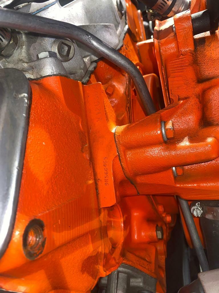

I do like this car - but I'm genuinely curious what the crew thinks about the engine stamp. Seems to have good docs but the partial VIN looks off to me.

124379N566465

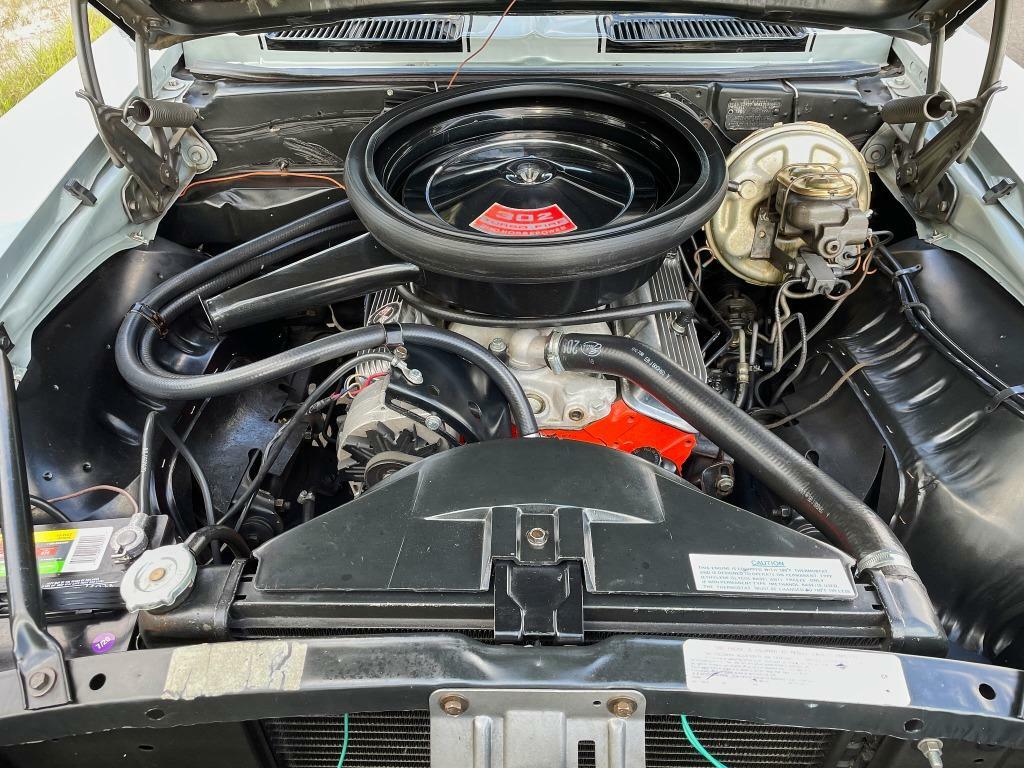

wayoutz 01-19-2022 10:32 AM
rear stripes are wrong. Always a deal killer for me
RALLY 01-19-2022 11:47 AM
Always thought the 69 Z-28 came with the cortez silver grilles only. Possibly the RS Z-28 could be a black grille?

VIN on pad looks stamped. Real X77 tag though
Kurt S 01-25-2022 11:40 PM
Engine pad is a restamp.

Alternator Pulley is not deep groove.
olredalert 01-26-2022 04:07 PM
----Just a guess, but maybe someone along the line didn't know that the serial # might be down by the bellhousing?.....Bill S
