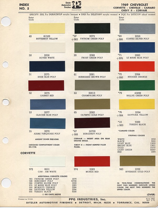

Code 67 Burgundy - Primer color? PPG #?
Hi Guys,
Two questions, which PPG paint number most closely resembles 69 Code 67, Burgundy?
What color primer is best to use for a close result?
Thanks,
Rich
ZLP955 02-24-2018 02:46 AM
Here's the PPG/Ditzler code chart for '69 Chevrolet models as listed. Not sure on primer color, the assembly plants used it in such bulk quantities that it seems to have varied (gray, red oxide, black), but a good paint supplier would be able to advise you.
http://images.tcpglobal.com/chips/19...rolet-pg01.jpg
