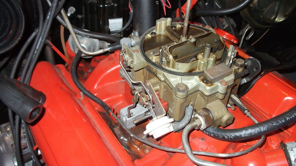

Verne_Frantz 10-15-2016 04:14 PM
'69 Chevelle 350 vacuum advance tube
Does anyone have a picture of the correct vacuum advance tube for a '69 350-300hp? I have the bracket for it on the intake but no tube. I've also switched from ported vacuum to manifold vacuum, (runs a LOT better) so the original tube might not work but I'd like to know what the original looked like.
thanks
Verne
Woj 10-15-2016 08:28 PM
Re: '69 Chevelle 350 vacuum advance tube
Here you go Verne. I rebuilt the engine some 15 years ago. It was stock to start with and that is the way I put it back together. All components are original to the car, except the fuel line. I don't think I have the metal vacuum line pushed all the way into the carb port in this picture.
Phil. W.
http://i262.photobucket.com/albums/i...psru4zsci9.jpg
Verne_Frantz 10-15-2016 10:48 PM
Thanks Phil. It looks just like mine (except for the dirt on mine). That front port is ported vacuum and I plugged it off. I'm using the long tube that sticks out of the side just in front of the choke coil. which is manifold vacuum. I think that long tube had a hose on it that ran to that flapper valve in the air cleaner snout. I might rig something up using a metal tube so I don't have such a long rubber hose going to the VAC.
thanks again.
Verne [img]<<GRAEMLIN_URL>>/biggthumpup.gif[/img]
Postsedan 10-15-2016 11:52 PM
Love it Phil [img]<<GRAEMLIN_URL>>/Can-I-Have-It.gif[/img]
Woj 10-16-2016 02:15 PM
Verne,
You are correct, the long metal tube near the choke pull-off goes to the air cleaner snorkel valve.
If you say it runs better off manifold vacuum, I might have to give that a try. My car runs great right now, but I think it would be worth checking out.
Phil W.

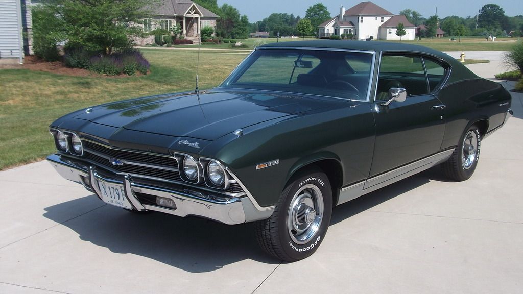

Woj 10-16-2016 08:48 PM
The 69 Malibu. Not sure if you have seen this one or not?
http://i262.photobucket.com/albums/i...psv6gz9sew.jpg
Damien 10-16-2016 08:50 PM
Very nice Phil. Good to see a Malibu in it's stock form. [img]<<GRAEMLIN_URL>>/biggthumpup.gif[/img]
Postsedan 10-16-2016 10:26 PM
I have seen Phil's Malibu numerous times.....each time she gets better and better.....Phil - Gets It [img]<<GRAEMLIN_URL>>/biggthumpup.gif[/img]
Ryan1969Chevelle 10-16-2016 11:18 PM
Wow, I forgot all about that Malibu.
Ryan
