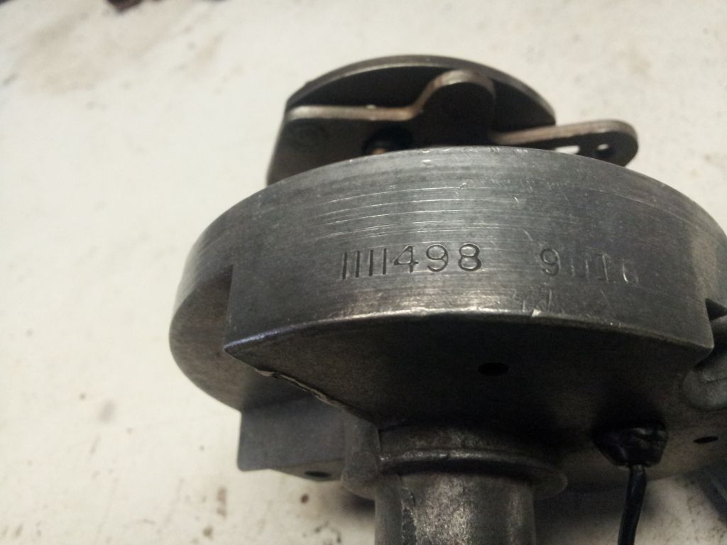

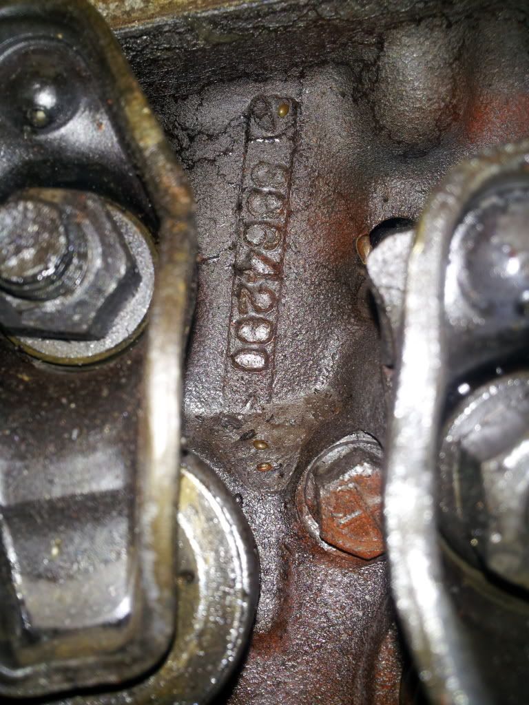

It depends when it was built. My L34 C JF motor was final assembled 7/28/69. Block is 3969854. Heads are 3964290. Intake is 3931067. Distributor is 1111498 and carb for a 4 spd is 7029215.
http://i1164.photobucket.com/albums/...803_143337.jpg
http://i1164.photobucket.com/albums/...803_143401.jpg
http://i1164.photobucket.com/albums/...2_205205_1.jpg
http://i1164.photobucket.com/albums/...ps6710a337.jpg
http://i1164.photobucket.com/albums/...229_193209.jpg
