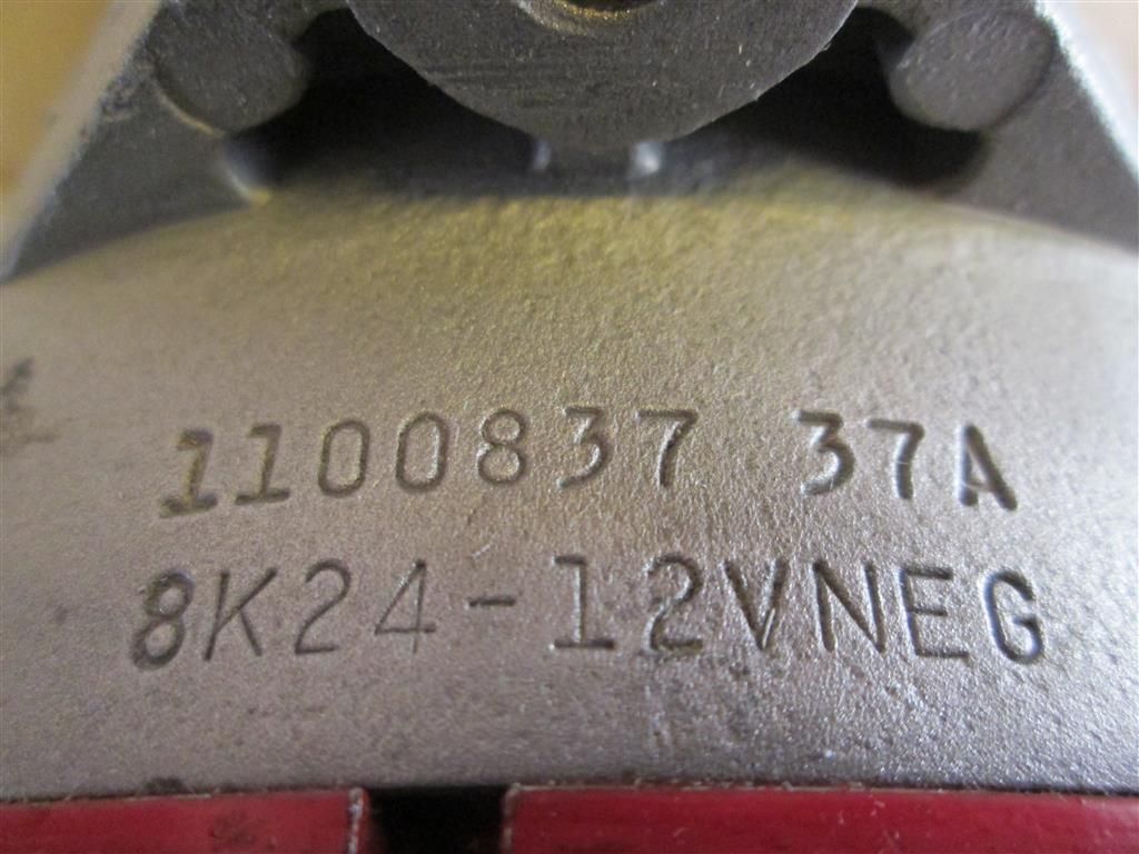

SuperNovaSS 06-01-2016 07:30 PM
Opinions on 1100837 Alternator Stamping
Any opinions on this stamping?
Thanks,
Jason
http://i179.photobucket.com/albums/w...pshzrva43r.jpg
http://i179.photobucket.com/albums/w...psflss3m34.jpg
http://i179.photobucket.com/albums/w...ps9z7th4yw.jpg
http://i179.photobucket.com/albums/w...ps575q386t.jpg
http://i179.photobucket.com/albums/w...pswjovgu7f.jpg
http://i179.photobucket.com/albums/w...psps1goujq.jpg

Here's another for comparison.
https://www.yenko.net/ubbthreads/ubbt...lternator-8k24
SuperNovaSS 06-01-2016 08:31 PM
Re: Opinions on 1100837 Alternator Stamping
Thanks Matt. That is what had me skeptical about this one. The K and N are wider along with many other differences such as the tops of the 3s stopping short and the 7s lacking the angle in the lower leg. I hate to accuse a restamp if it's not the case though. That is why I wanted to get some input.

m22mike 06-01-2016 11:47 PM
Jason, I do not think it is real. Here is another close date to look at.
https://www.yenko.net/ubbthreads/pics...837_8k29_2.jpg
the427king 06-02-2016 12:15 AM
jason,, NG on that one....
SuperNovaSS 06-02-2016 12:23 AM
Thanks guys. I agree. I just wanted to be sure. It's too bad all the restamps aren't terrible. An unrestored one seems to be the best way to go anymore.
