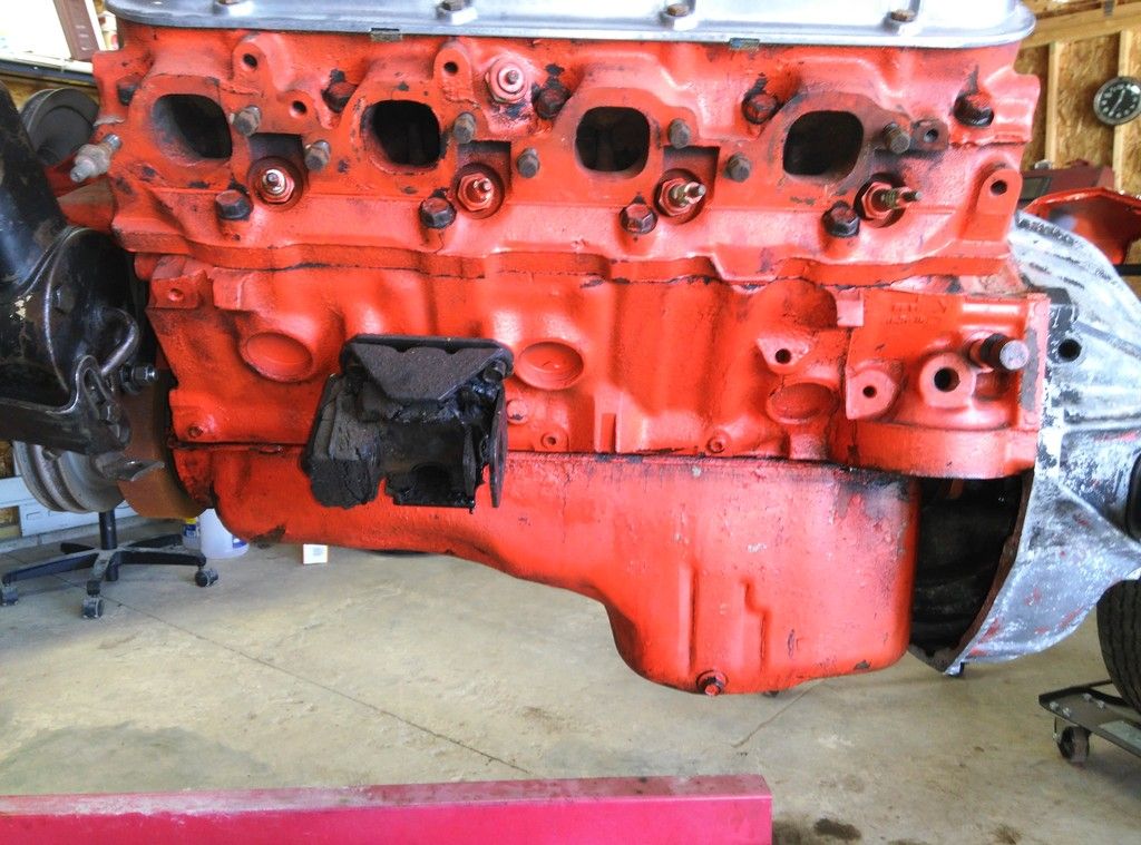

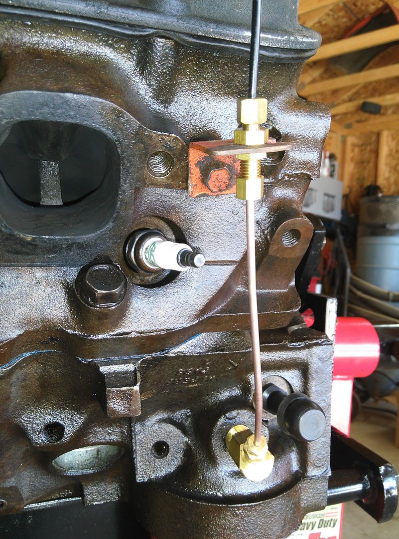

You can see the water temp sending unit just above and in between the 3 & 5 cylinder exhaust ports on my motor here. The oil sending unit hole is empty in the first pic, but it's mounted in the second.
http://i1164.photobucket.com/albums/...424_123648.jpg
http://i1164.photobucket.com/albums/...416_173914.jpg
YENKO DEUCE REGISTRY 05-03-2016 08:26 PM
Re: Oil & Temp switches on BBC
Thanks both, great pic's. I will order the parts today.
