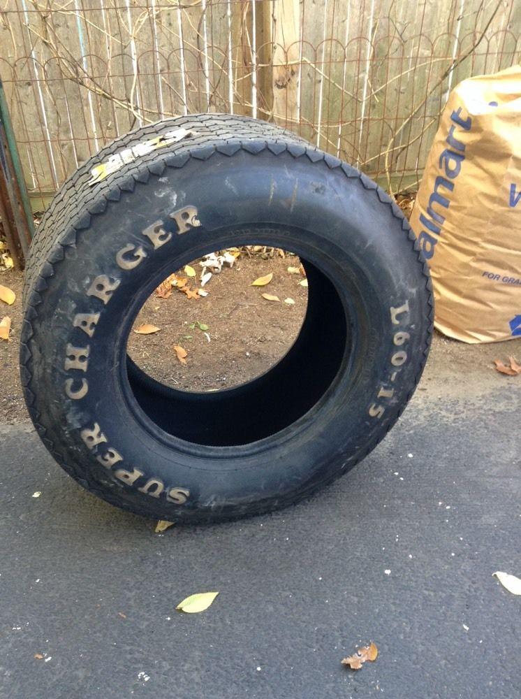

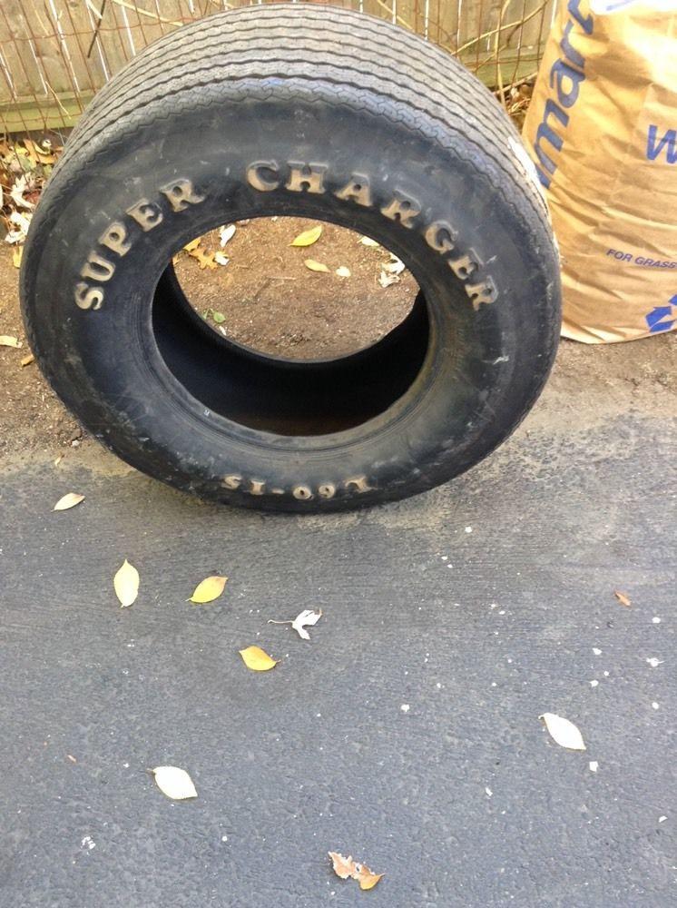

Here are the tires, so wetsanding? hmmm never thought of that. Thanks
mockingbird812 11-17-2015 06:03 PM
Re: Get my NOS Day 2 Tires Like New Again
Cool tires! 2nd photo of tire: lettering should clean right up with Bleche Wite or paint thinner or the like. 1st photo may need some touch up as it appears that the white color did not transfer to tops of some of the letters.

I have some Ranger Tire paint, and some acrylic white art pens for the touch ups. I may use that. Not sure about using a rubber roller rejuvenation product, like a copy machine? Have heard that but haven't seen anyone try it. Not a huge fan of the "off the shelf" make your tire shine products.

Don't use any paints or white letter paints etc-don't do any sanding etc, rubber roller rejuvenation etc.Youa re going to ruin your tires.
I had a set of NOS N50 Pro Tracs from the mid 70's.. Used Westleys Bleche white on the letters with a stiff brush and the tires as well and they came out like new and they looked way worse than yours.
I use Team 303 Protectorant as it has no alchohol or petroleum in it that destroys rubber like STP or Armor All. The RV association of America recommends Team 303. Gives a nice even black sheen
After Team 303 they look like new.
