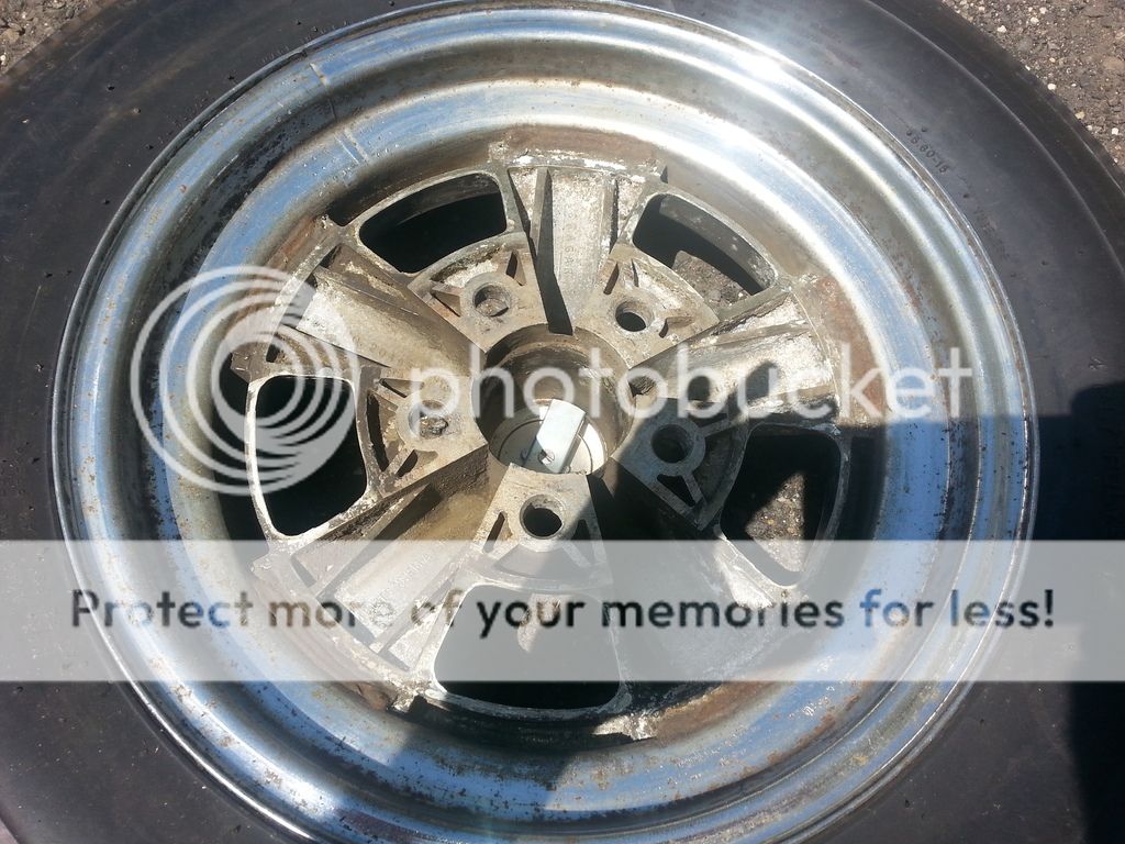

PxTx 05-03-2015 04:41 PM
Re: Will hurst wheels clear 67 4 piston gm calipers??
http://i710.photobucket.com/albums/w...szeghs74z.jpeg
Looks like they have just a bit more clearance than my Cragar SS-which i know needs a spacer on the early 4 piston disc cars. Seems very close. Not much help, but figured I would bump the thread for more input.

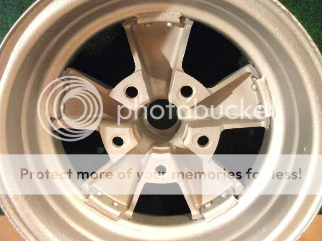

PxTx 05-03-2015 05:55 PM
Here are the Cragars which I know require a spacer for the 4 piston calipers. Hope this helps someone.

PxTx 05-03-2015 09:30 PM
Good point Richard! When using the spacer, it is best for 6" and narrower when using popular Cragar offsets, though custom ones can be made for 7" fitment. If you run longer wheel studs, then standard lenth mah wheel lugs are fine, but you'll need them to be open so the stud doesn't bottom out on the lug cap.
Scott, i suspect you'll need the spacer and then some longer lugs trimmed down. Hope to see pics of what you're working on!
