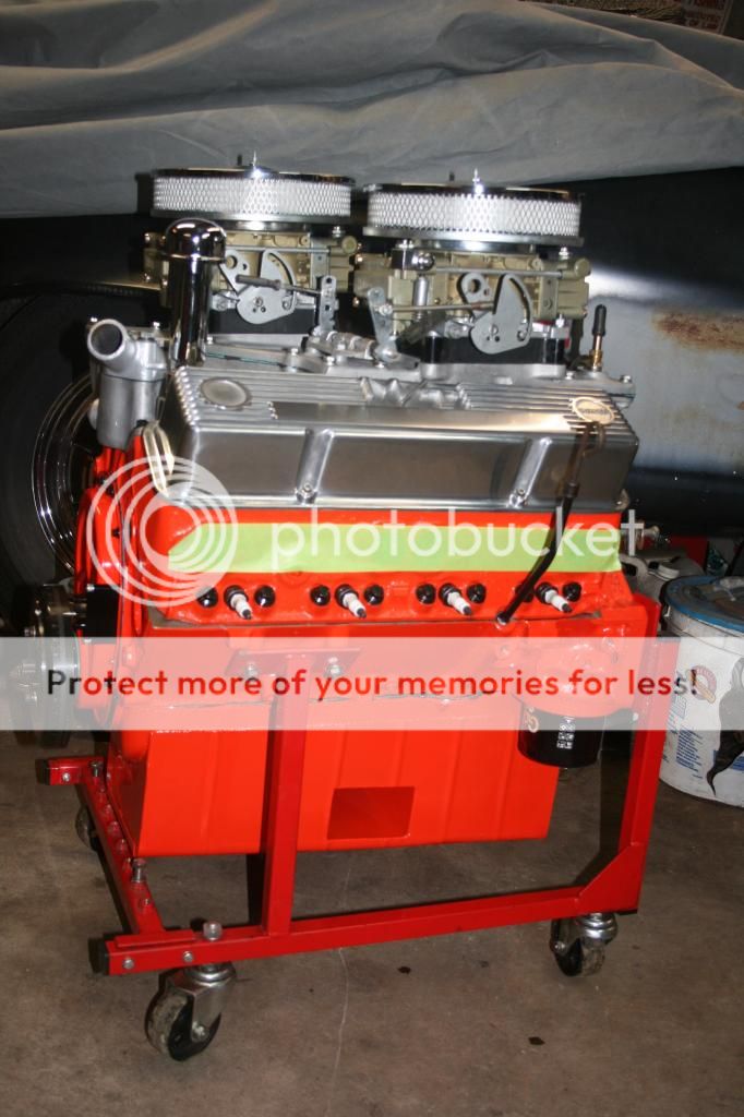

The 350 LT1 that is currently in the car was due for valve springs and some other freshen-up components so we decided to try and trace things back to its 1968 Day 2 configuration. Keeping with the spirit of that idea, we sourced a 1968 CE block from sYc member Danny D. It was a virgin bore motor and in excellent condition 3959512 dated J 10 8 with CEO 0899 10 stamped on the pad. thread for ref: http://www.camaros.net/forums/showthread.php?t=203132
Next we bought a set of 1968 291 heads which are original 2.02's. Fortunately, Tim Napa68 had just what we needed. The heads got a full overhaul. Other than a bit of bowl work behind the intake valves, the heads remained stock. Ports were all left untouched. We did knock compression down to 9.3:1 to be more street friendly and with a good ring package we don't think we're losing much dynamically over the OE slugs and rings. Bearing spacers to run a 283 crank.
Had a bit more fun with the Day 2 theme and topped it off with an Edelbrock STR-10 intake and a pair of 660's. Tossed in an old points distributor we were lucky enough to run on Nova Jed's SUN Distributor machine.
http://i710.photobucket.com/albums/w...psb895f420.jpg
Cam selection isn't gonna be made public for whole world to see/debate. Just grab me at a show if you want to talk. This is just the beginning of the whole Day 2 revival and I'll be looking forward to updating you as it evolves. The key points here are that we have relatively stock 1968 casting 291 heads, 9.3:1 pump gas friendly compression with an old school Crossram intake carbureted and an old school GM points distributor cranking out over 500 hp with as many Day 2 parts as we could use! We couldn't be happier! These results were with 93 octane we picked up on the way to the dyno from a random Sunoco station.
