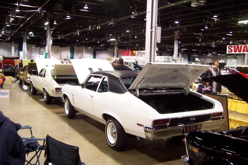

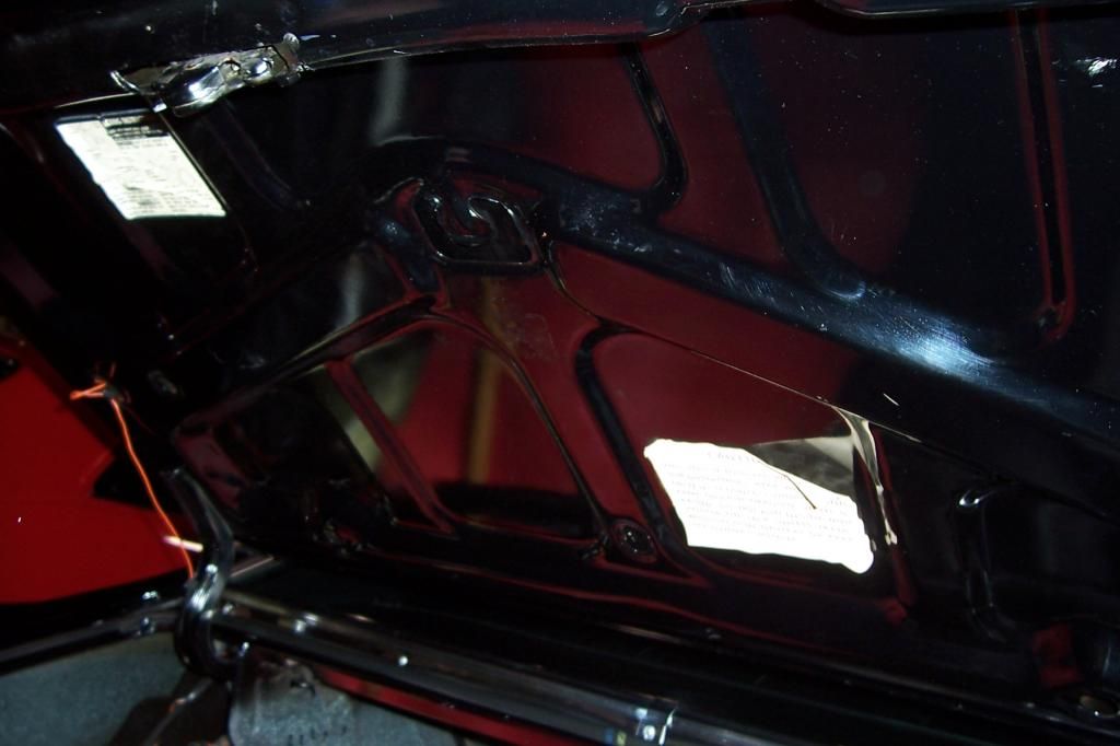

This is my 70 L78. The original stickers were found in this placement pattern. The spare tire being upper right and lower left being the posi decal. I have also seen this placement on unmolested, unrestored 69s... One of which being in the 1969 Hot Rod Magazine article "13 second grocery getter". There is a picture of the trunk open on that car that shows this placement also. I don't have the article handy..
http://i268.photobucket.com/albums/j...icture2334.jpg
This picture is of Tom Williams' 70 L78 black Nova unrestored. Notice the opposite side placement.
http://i268.photobucket.com/albums/j...icture3460.jpg
Hope this helps.... Rich

Thanks for the pictures Rich.
