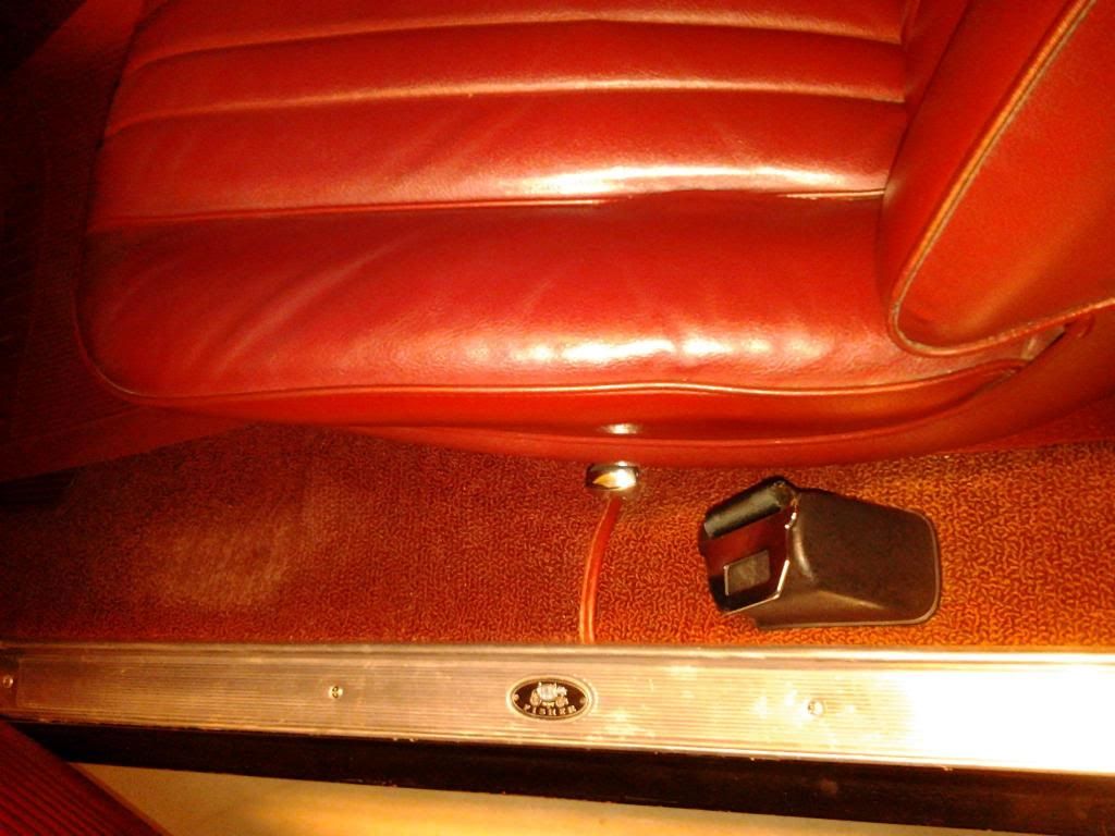

Here's a few photos of my 69 Chevelle SS, unrestored, seats never out.
Hope this helps. I also have some loose 69 buckets if you need more photos. Those I will have to take, these were on file.
Phil Woj.

pcf_mark 04-08-2014 01:39 PM
Re: Seat tracks, seat belts, seat install
These look exactly as I expected! Thank you very much. Now to figure out why mine are so fouled up. My belt retractor is in the same place relative to the sill plate. But the plastic seat trim up against the retractor (without the cover even on) solid.
Are tracks and seats location specific? I switched them all around but maybe a photo of a seat bottom with the track on would clear this up. Who would have thought THIS would bring me to a stop???
Thank you for the photos.
