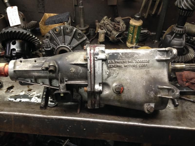

Hi All,
How does the below trans decode?
Thanks,
http://img.photobucket.com/albums/v4...ps191a3d63.jpg
http://img.photobucket.com/albums/v4...ps79d4a90b.jpg

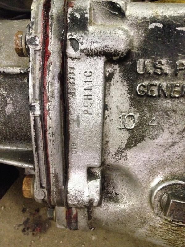

WILMASBOYL78 01-19-2014 04:16 PM
Re: Muncie Trans Decode
Looks like an over the counter or warranty transmission...June 11, 1969 assembly date...C = M22

How do you know its a warranty trans?
scuncio 01-20-2014 08:08 PM
CT9 = Chevrolet Transmission 1969 (year of build)
Kurt S 01-24-2014 01:21 AM
Is that CT9 A38333 or 438333?
Thanks!
MosportGreen66 01-24-2014 12:37 PM
Hi Kurt - The first character is an A
