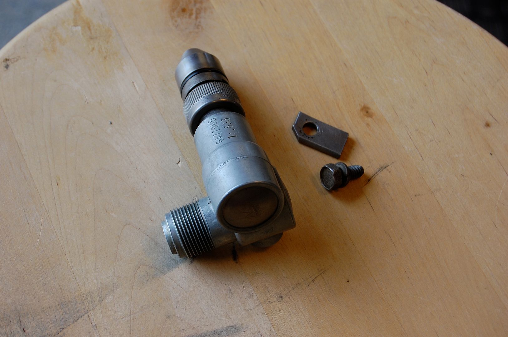

SS427 06-05-2013 11:25 PM
Re: 4.10 trans gear reducer
1 Attachment(s)
Thanks for the picture Sam. I think that it may be different on the 70 Z's due to tire size. Also, from the photos I have been looking at it is the same unit the Chevelle uses though the one you posted would certainly fit a lot better! This is a shot of low mileage Z28 with 4.10 so I assumed that is the style these came with???
SS427 06-06-2013 02:18 PM
With a little help from Chris White and some GM books it appears that I need two of the .8241 units. Thanks to all for the help.
YENKO DEUCE REGISTRY 06-06-2013 04:50 PM
I've only seen the round type on the Deuces/Z28's, never the square type.
