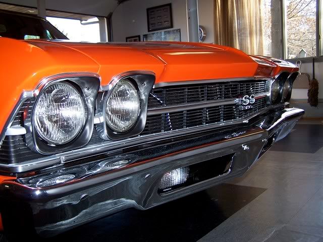

Are you guys thinking about a 1970 ElCamino? They have round park lamp/turn signal lenses in the bumper. I am thinking the 69 ElCamino had rectangular lenses - larger than the coupes and sedans - in the same cutout area in the front bumper where the coupes &amp; sedans were.
Bill Rose 06-05-2013 04:28 AM
Re: '69 ELC parking lights different than Spt Cpe?
The 69's have rectangular parking lights that are bigger than the Chevelle lights. The big round lights in the bumper was new for the 1970's.
http://i533.photobucket.com/albums/e...d/100_2184.jpg

Verne_Frantz 06-05-2013 12:10 PM
Mine look like those in the photo. Larger rectangular.
