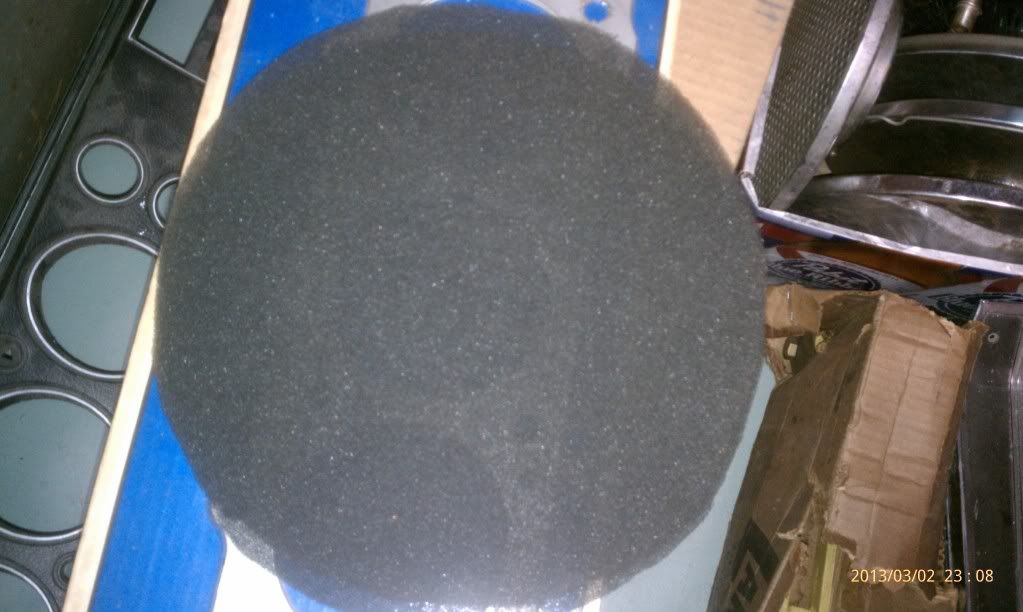

C1SS396 03-03-2013 04:27 AM
Re: Filter Foam for a Fly Eye Air Cleaner???
<div class="ubbcode-block"><div class="ubbcode-header">Originally Posted By: Hemicolt</div><div class="ubbcode-body">I made mine using the foam filter material sold at Lowes. It's used against the face of window type A/C units. 4 years and have never had a problem.
</div></div>
Yup i agree 100% with Hemicolt.Frost King AC filter only a few bucks from lowes .They are fuel proof been using them for a few years .You can make 2 elements from 1 package.Copy and paste link to lowes page with the filters .
http://www.lowes.com/pd_78359-1410-F...amp;facetInfo=
http://i263.photobucket.com/albums/i...ps2a32a1bd.jpg
http://i263.photobucket.com/albums/i...ps01cb16e7.jpg
Born30YrsLate 03-03-2013 04:02 PM
<div class="ubbcode-block"><div class="ubbcode-header">Originally Posted By: C1SS396</div><div class="ubbcode-body"><div class="ubbcode-block"><div class="ubbcode-header">Originally Posted By: Hemicolt</div><div class="ubbcode-body">I made mine using the foam filter material sold at Lowes. It's used against the face of window type A/C units. 4 years and have never had a problem.
</div></div>
http://i263.photobucket.com/albums/i...ps01cb16e7.jpg </div></div>
Looks like someone likes PBR...or at least also finds beer cases useful for storage containers... [img]<<GRAEMLIN_URL>>/beers.gif[/img]
