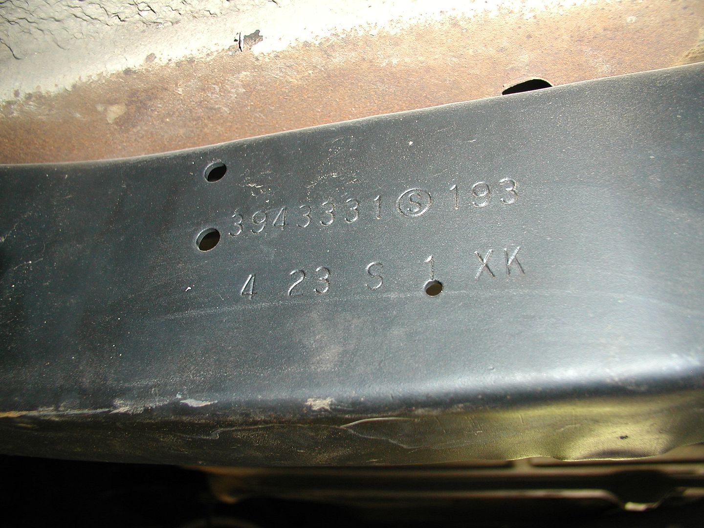

mockingbird812 04-21-2012 09:34 PM
'69 'velle frame: part no./partial VIN location
I can't remember if 69s had vins stamped on the frame. Where are the part nos. stamped? Same as 70s?

Postsedan 04-21-2012 09:55 PM
Re: '69 'velle frame: part no./partial VIN location
Sam,
Yes.
http://img.photobucket.com/albums/v6...an2012/236.jpg
mockingbird812 04-21-2012 09:57 PM
So that is a part no. and month/day? Looks like it is on the side of the frame (behind driver's side rear wheel)? VIN?
Thanks Dan!
SS427 04-21-2012 11:50 PM
Sam, contrary to popular belief not all plants stamped the VINs on the frame, some were hit and miss and some struck multiple times. If there is a VIN the most common place I see is almost directly above the part number area on the top part of the frame. I would check everywhere along the drivers side rail and even the rear crossmember just in front of the bumper on the rear side as a few have been found there.

XXXGoldL34M20 04-22-2012 01:17 AM
1 Attachment(s)
My 70 has it stamped without a VIN and it is an Atlanta built Chevelle.
Donnie 04-22-2012 04:57 AM
my Atlanta 70 has the vin stamped on top of the frame pass. side all the way at the back.
my Atlanta 69 has no vin stamped on the frame.
Don_Lightfoot 04-22-2012 05:26 AM
<div class="ubbcode-block"><div class="ubbcode-header">Originally Posted By: Donnie</div><div class="ubbcode-body">My Atlanta 69 has no vin stamped on the frame. </div></div>
Interesting Donnie. I have been unable to feel or see with a mirror the VIN on my Atlanta 69. Frame #, date, code and manufacturer are there though.
SS427 04-23-2012 12:52 AM
It was a federal mandate to stamp the frames and bodies with VIN's yet I have to say the vast majority of Chevrolets I have had apart over the years (into the 100's) did not have VIN's stampted on the frame and as I said earlier, some had multiple stamps. We also know many Atlanta cars did get CON VINs stamped anywhere on the firewall.
