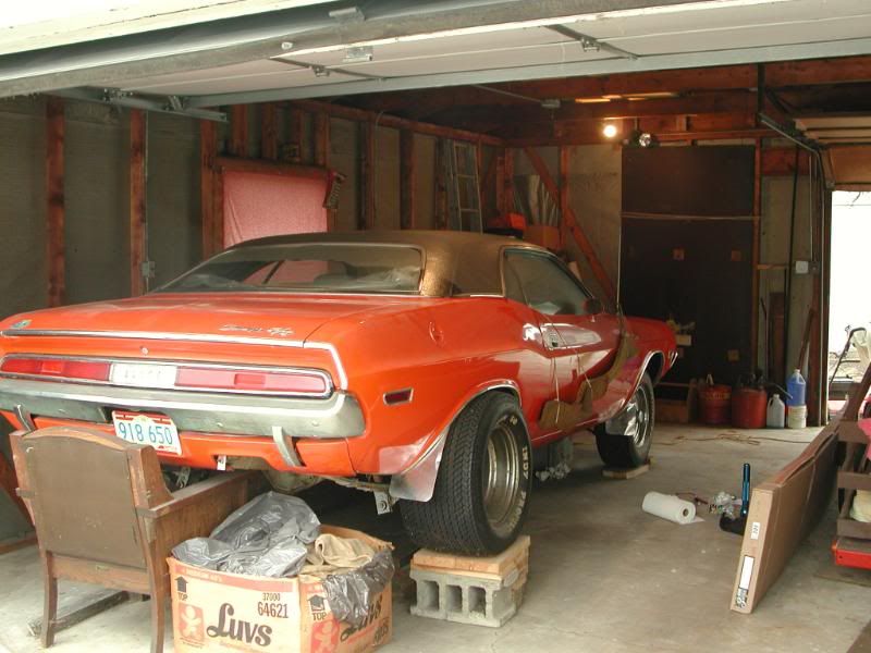

I lost the blue helper coil springs that were under this car to keep it from bottoming out.
I got the rocket wheels and tires ready to go back on it.
Air shocks on it (yellow, I think monroe) do lift the car.
questions are, do I and where do I find the right helper coil springs to keep it up? and is that the best way to raise the back end and have it ride as good as it could.
any advice appreciated
I am tempted to have the springs re-arched, or talk to eaton spring in detroit to get new leaf springs with lift built in. Eaton made springs for me once (55 chrysler C300 hemi) and they were perfect and raised the back end.

I would have the springs re-arched by Eaton and use air shocks at a low pressure as back up for when you might hit a bad bump unexpectantly. I would never trust the springs when the tires are directly under the quarter panel..or stick out past the quarter.
You will have to use the Mr Gasket shock extensions again as what was on the car in the photo. They are still available from Mr Gasket in case you lost the originals.

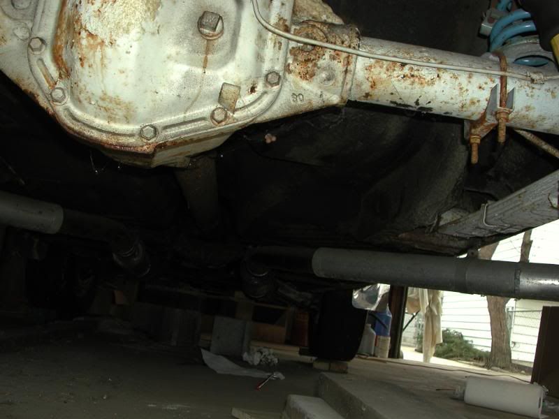

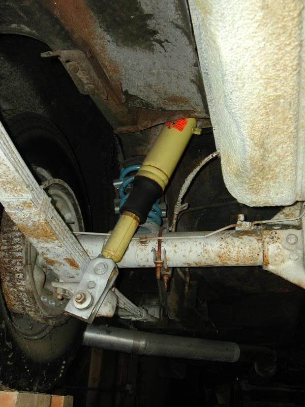

here is what I refered to as helper springs
that is what I unfortunately threw out (with the coil bases too)
I will buy those extensions from mr gasket (thank you)
http://i358.photobucket.com/albums/o...DSCN0934-1.jpg
http://i358.photobucket.com/albums/o...DSCN0933-2.jpg
whitetop 01-07-2012 05:55 PM
Re: need help in day2 restoration
I think you will be fine with just the re-arched springs/air shock combo. Most people back in the day just used air shocks. Original owner probably used the extra springs because the leaf springs were not re-arched and wanted extra security.
It would look cleaner without the extra springs.

There is so much room with those wheels if you got a more favorable offset to run the same size tire under the car without sticking out, is there any consideration for running that way?

<div class="ubbcode-block"><div class="ubbcode-header">Originally Posted By: pxtx</div><div class="ubbcode-body">There is so much room with those wheels if you got a more favorable offset to run the same size tire under the car without sticking out, is there any consideration for running that way? </div></div>
15 x 10 rockets I have wont fit iside the wheel well with the offset on them, with the mickey thompsons.
If I got a custom offset and ran L60 15, then that would fit.
I will check into new air shocks to replace the ones on it, and run separate lines as advised. I knew that made sense.
