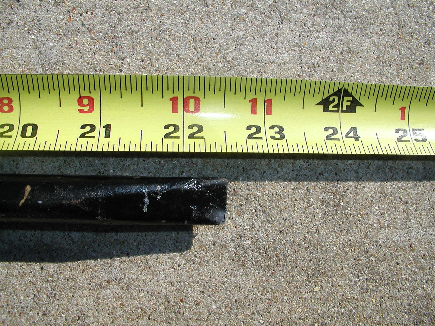

Tire iron measures 18 inches

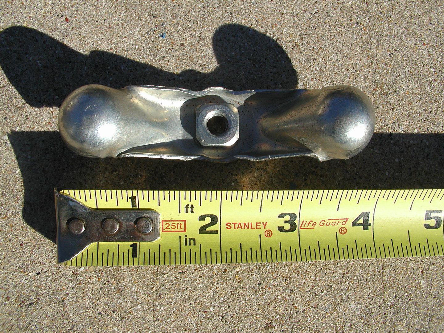

Wing nut measures at 5 inches

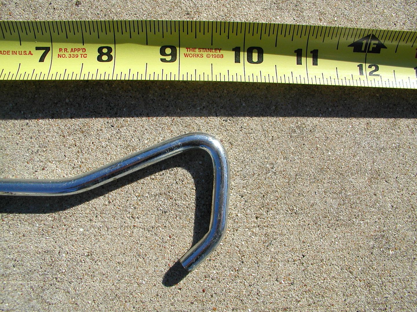

Hook measures at 6.5 inches

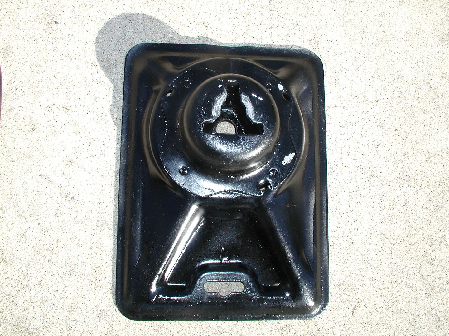

Base

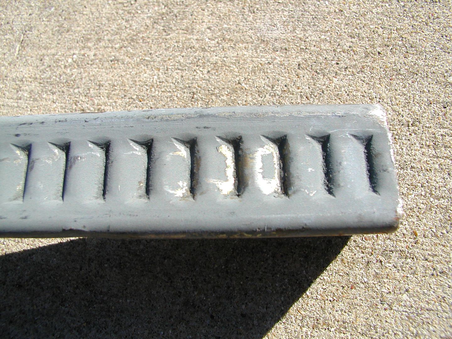

Shaft was painted by someone, you can see the original Gold Zinc.
