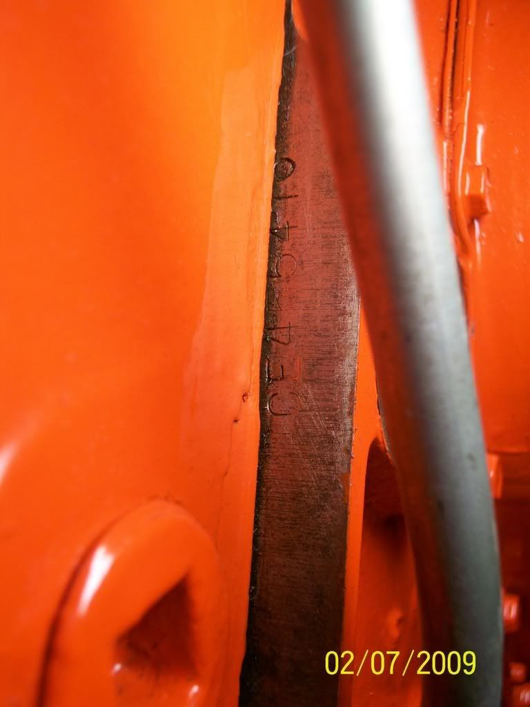

69 Post Sedan 02-20-2011 07:53 AM
Re: CE engine identification number
The first number after the CE is the year the block was assembled.
For example: This block is CE455416. The first 4 designates it as a 1974 and the 55416 is a number that Tonowanda used.
Kurt

69 Post Sedan 02-20-2011 06:15 PM
<div class="ubbcode-block"><div class="ubbcode-header">Originally Posted By: fastchevy69</div><div class="ubbcode-body">Cool, thanks for all the help!
Now, say I don't have the paperwork from the dealer saying when this engine was replaced, do you guys know if there's a way of tracking these engines through Chevy? As in which dealership it would've been sent to? </div></div>
No but if you find out a way, let me know. The picture I put up is of the CE block in my Chevelle and would love to find out more info.
