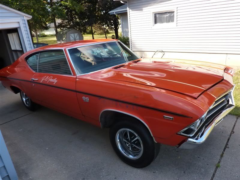

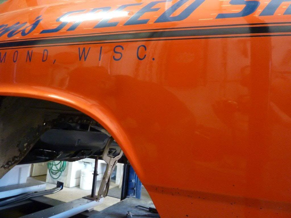

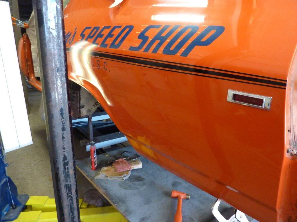

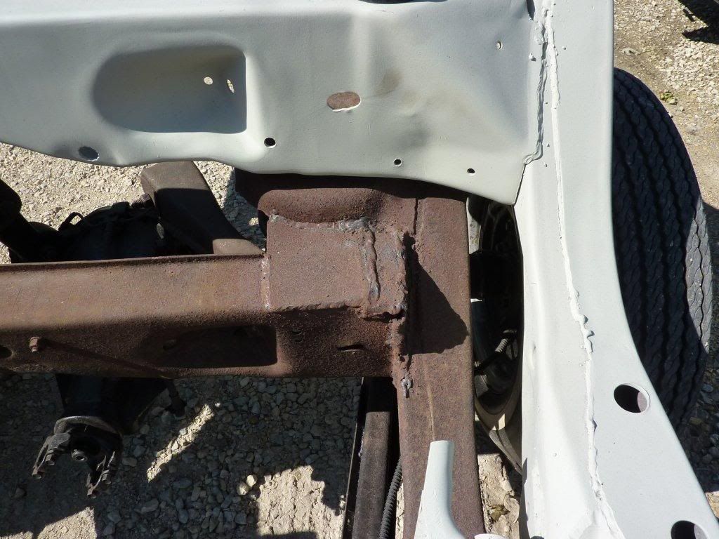

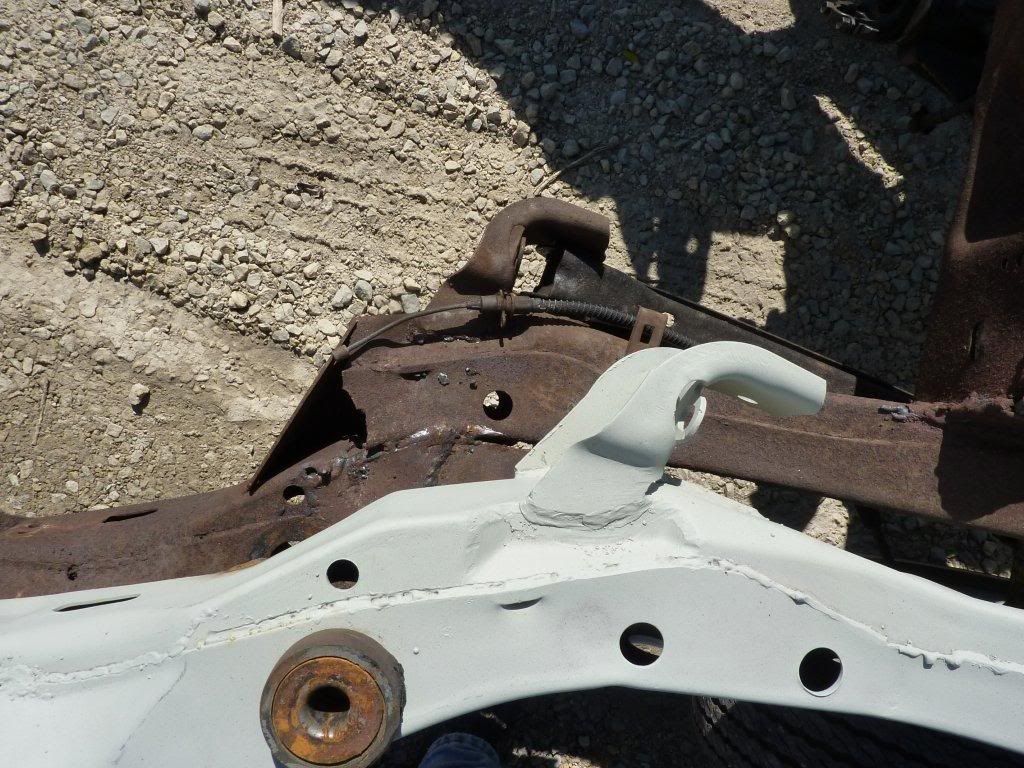

This is a friend's L78 Chevelle that he bought new in 1969. It's the first time the car has seen daylight in 30 years. He had someone tub the car a long time ago and they screwed it up. Basically when the frame was narrowed and they welded it back together, the rear frame rails sat too low. When they bolted the body to the frame, the body buckled on both sides. I need some opinions on how to fix it. It obtains the <span style="text-decoration: underline"><span style="font-weight: bold">original </span></span>Monaco Orange paint on the car. I hate to see it get painted if it's not necessary.

njsteve 10-18-2010 01:17 AM
Re: 1969 Chevelle L78 Monaco Orange
Sounds crazy but would bolting the body to an original unmolested frame work? Either bolting it down as is or by adding shims to the outer body mounts to pull the center down and relieve the stress creases?

Steve Shauger 10-18-2010 01:53 AM
That car looks awesome. I would a good frame straightening shop could work their magic on this body. Keep us posted on your progress.

Here are some more pictures that was taken the same day. The damage on both quarters can be seen pretty good in a couple of the pictures.

70ChevyGuy 10-19-2010 07:53 AM
Get a new frame, relieve the stress and find a very skilled PDR guy. Neat find. Everything's fixable.
