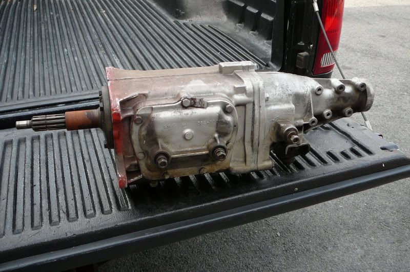

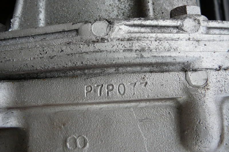

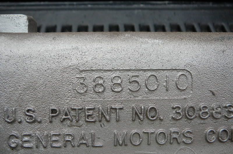

Hi Guys,
How does this trans decode and what is it's approximate value?

M-21 close ratio Muncie, built Sept. 7th 1966 to be used in a 1967 model year car...
Without seeing inside the sidecover, can't say what its worth... Crash
