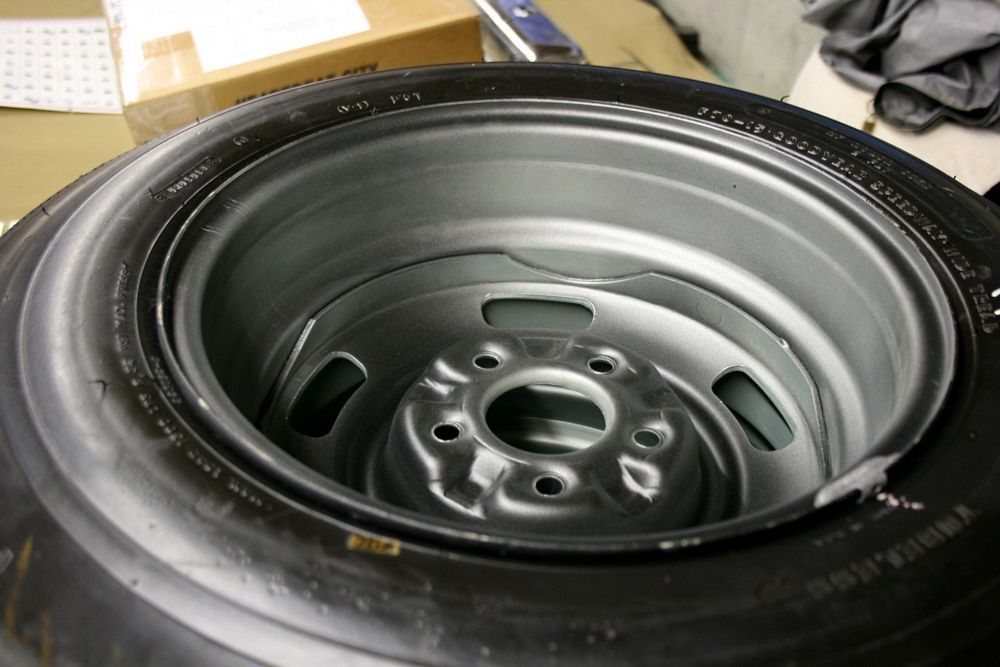

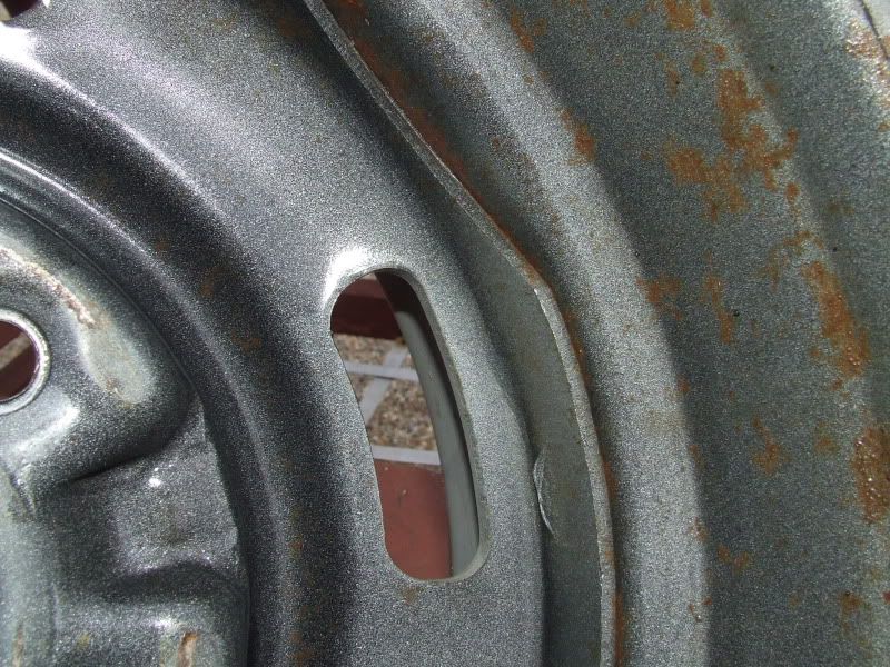

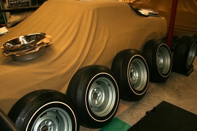

737Driver 04-21-2010 05:36 AM
Re: Corvette Rally Wheel Restoration
A wheel for your car would have had, most likely, A LOT of green tint in the paint. It would have had runs/slags as there was minimal care taken to prevent it.
http://img.photobucket.com/albums/v4...Driver/011.jpg
http://img.photobucket.com/albums/v4..._WheelPICI.jpg
When the argent was applied to the front, the paint continued through the openings right on to the black back and created substantial coverage.
http://img.photobucket.com/albums/v4...WheelbackI.jpg
http://img.photobucket.com/albums/v4...heelbackII.jpg
One brand of wheel weights was Micro. No metric sizes were used and there was a pink color applied to indicate location and/or size.
http://img.photobucket.com/albums/v4...ver/MicroI.jpg
The PICS shown are from original tires, wheels, weights and valve stems. In my opinion, they indicate what a factory fresh wheel would have looked like exiting the assembly plant. The wheels are, however, RESTORED. There is never a better example than an original, non restored component in good condition to give the best example of 'how it was' in the day.
