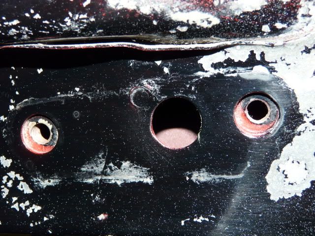

Most of the paint I see used is too dull it actually had some sheen to it, this is the factory shade on my 68 in the rear wheel house and frame and one with the bump stop removed to see the shade under it
http://i226.photobucket.com/albums/d.../beater024.jpg
http://i226.photobucket.com/albums/d.../beater003.jpg
